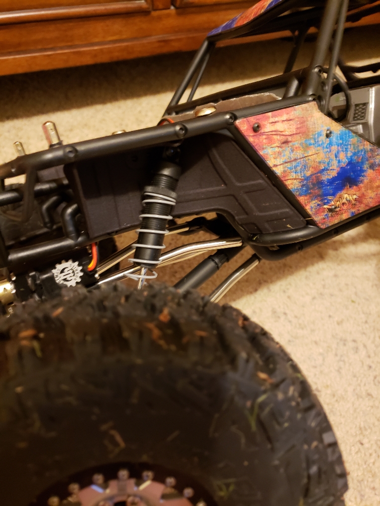

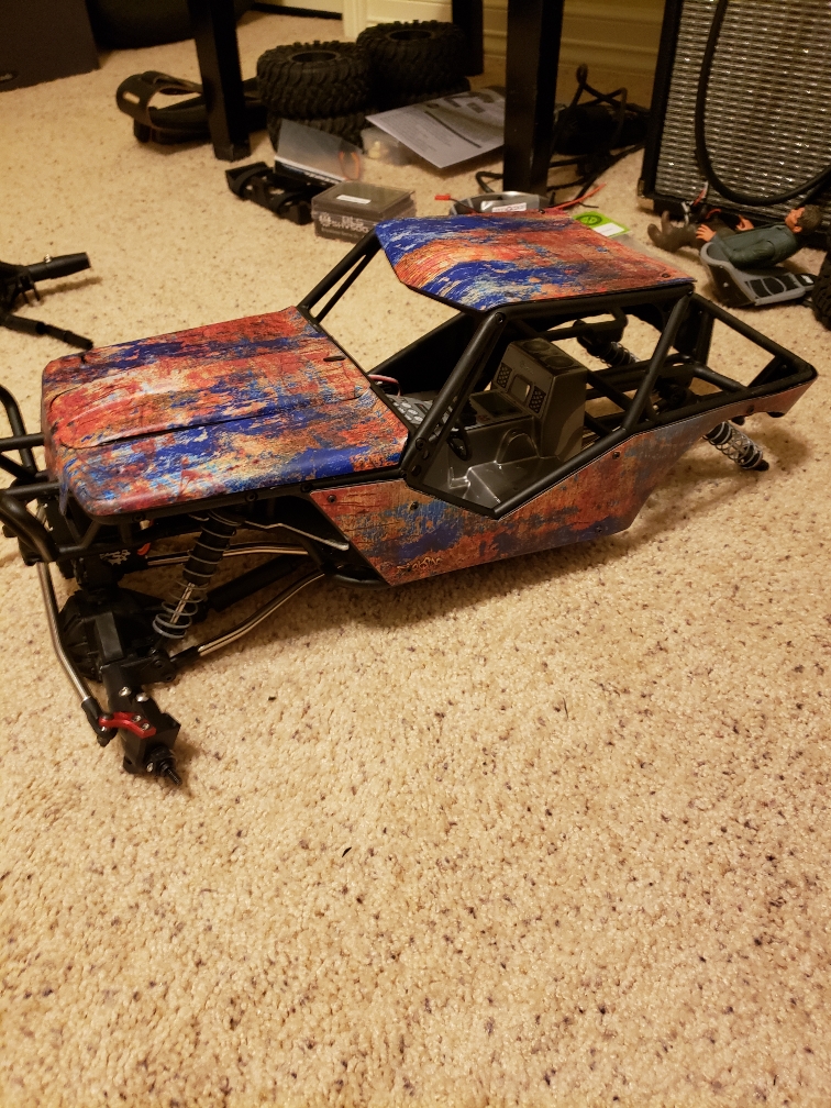

Mine has transformed from a Spawn. It's coming along quite nicely. First time doing wraps.

That looks pretty cool with that wrap! I've owned my Wraith Spawn pretty much since that model came out but it's been in storage for about 5 years. Just brought it out and been playing with it since the Covid quarantine, luckily I stored my Lipos correctly and they seem to be working just fine! Anyways I was able to glean some fresh knowledge from your post so thanks, I like that battery tray you picked and will possibly get the same one. My truck is nearly a stock Spawn, I modded the stock battery tray into the front and cut the hood so it's removable but was never fully happy with how it ended up, that tray will make it worlds better. The only other thing I've done is slap in a MG steering servo that I've had for YEARS after my stock servo was destroyed by my son prior to the truck going into storage. I'd love to see where your truck's at now if you're still working on it.

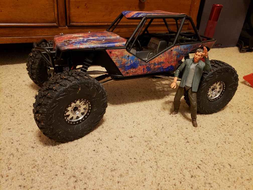

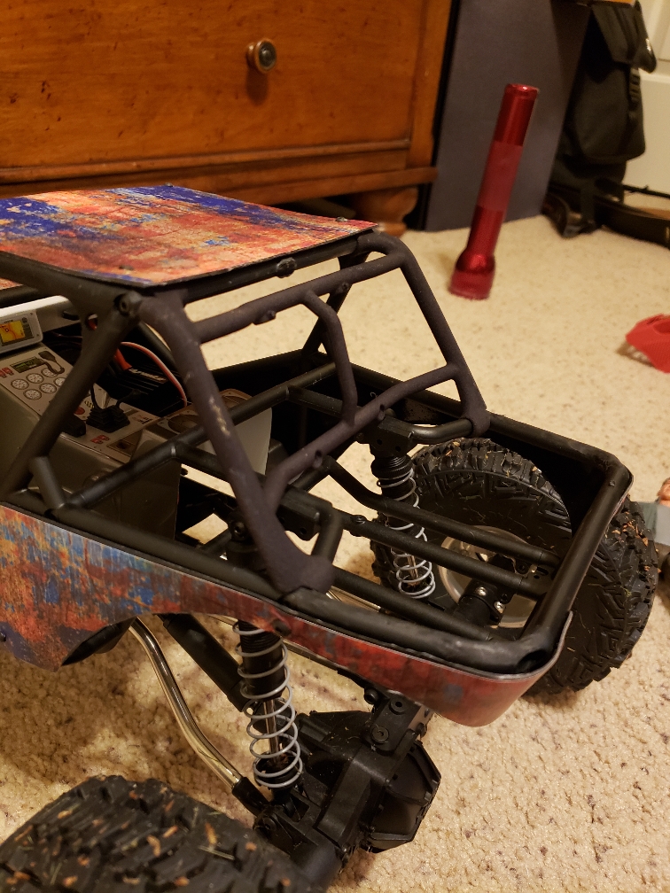

Here she is as she sits currently. I finally got around to fixing the hood issue as well. Now I just need to put seats in it for ol Harrison Ford.
I got a fastback part from Shapeways. Also got front wheel wells from there too.
I upgraded the hubs, knuckles and steering arms with the Vanquish kit. I put Beef Tubes AR60 aluminum tubes in the axle housing to strengthen it some.
I need to redo the shock fluid as it still has the stock setup. I did replace my servo to a Holmes Hobby. Man that thing can move the big tires. I plan to add some lights to it as well. I need to get a metal servo mount. The stock plastic one is garbage.
