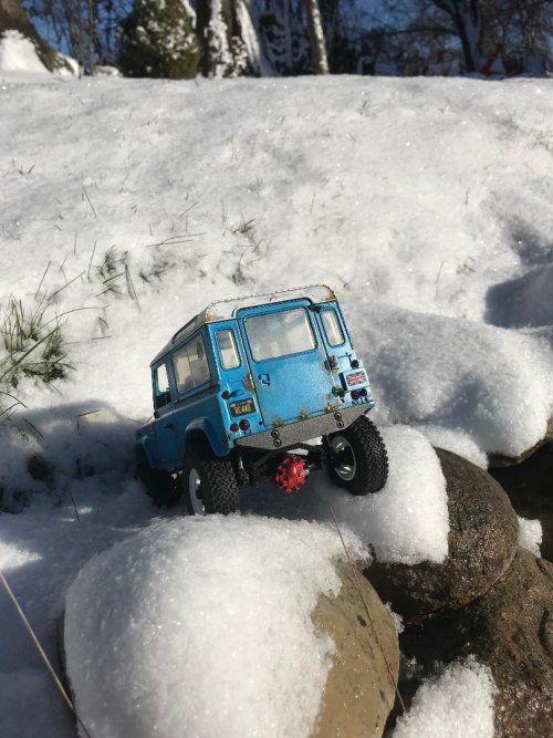

Had so much fun just stomping some trails in to the snow with my foot and driving this little rig around. What a hoot!:lmao: It actually performs fairly well with the single motor. Can't wait to see what the dual motor set-up is capable of.

I have to say, if you've been hemming and hawing about picking one of these little rigs up, just do it. You will not be disappointed. For such a tiny little truck, it's pretty darn substantial with metal chassis, axles, bumpers, hard body, etc. The scale detail for a rig this size is pretty amazing as well. I've also been pleasantly surprised about its box stock capabilities. I've got all the upgrades on the way, but there is no reason you couldn't run it just the way it is if you did not want to mess with it or spend the $.
I was flabbergasted that it was consistently cleaning this descent on my little side yard course. Also surprised about it's capability to track through the snow. It's not exactly deep, but we are talking 1/18 scale. IDK - I've just been laughing like a little kid wheeling this thing around the little trails I've been stomping in to the snow.:lmao:
Passenger side mirror did break off again after I superglued it, but that's about it. Probably going to lose the drivers side one as well. They stick out a good bit and as I said, the rig has some heft so they're bound to break in roll overs. No biggie tho. I don't plan on replacing them.
