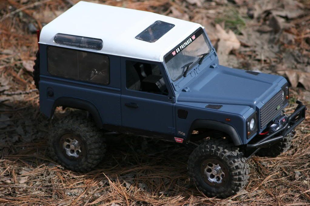

My old D90 build on the same chassis/wheelbase as the dingo. Also ran a 35T in there. Good setup for it.
Re: New built info (landrover d90)
Looks good mate. Any tips on mounting the body?
A few ways you can go about it. I used the factory SCX10 rear frame cross member for the rear and then made a flat mount for the front using heavy duty velcro.
You can see it here on the front of my Defender 110
