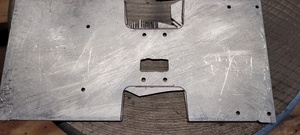

Made a chassis from 1/8 aluminum.
Band saw broke
Cleaned up nicely

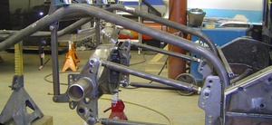

Roll cage?
Hmmmmm, interesting
Time for nawwwwwssssssss
I mean It has the room, why not?
Die cast engine up front. Partial interior, a roll cage, a huge 3674 motor or similar in the 2400kv flavor. I may take one of the diecast scx10 phat axle housings to add some weight to the rear. Oh front tires are Duratrax bandito 2.8 ST and the rear MT 14mm hex. I think i may try to stuff a tiny edf jet unit in there for 1 cooling and 2 the F150 Lightning is supercharged, so......
