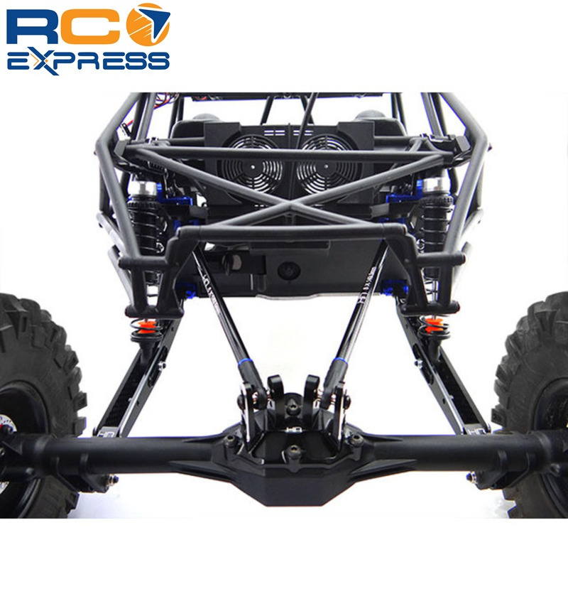

The bottom arms and the driveshaft seem to be my issue...My idea was with this to extend the rear the 49mm use the UDR style twin shocks and an upgraded anti sway bar...the upside to longer arms is it should have more droop and articulation and more stability at higher speed due to the longer wheelbase, turns might still be sketchy though.
1/10 https://www.rcexpress.net/images_subdir/61/lrr56u01-4.jpg
SBR https://www.bigsquidrc.com/wp-content/uploads/2017/12/Losi-Super-Baja-Rey-6.jpg
