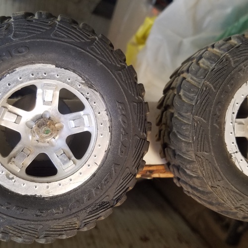

Decided to try out the Tamiya high lift tires. The are pretty hard which is good. The size is close enough to work, especially after I stuff them with some very firm foam.

I'm really happy how these turned out. Stuffed them with my homemade foams and they are very stiff now. Almost like a solid rubber tire. They are a little arched at contact patch which is perfect when doing a tight turn. Going to make another set of these for my other trailer. http://www.rccrawler.com/forum/scale-accessories/467846-jebsters-trailer.html
If you were curious about how I make the foams I have a couple pics below. Use a jig to cut circles out of the foam mat using my bandsaw. Just drill a small hole in the mat then slide that onto the long screw on my spacing jig. After that use a hole saw bit to cut the center out. Takes about 10 minutes to cut all the foams I need with this setup. Bigger challenge was getting it into those hard rubber tires!
