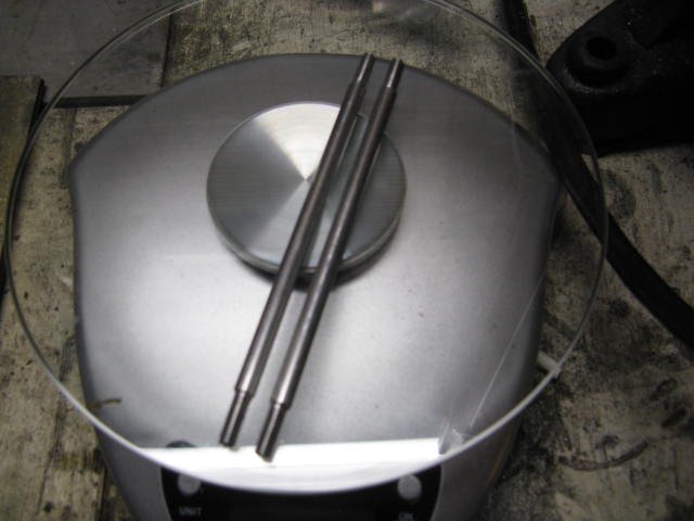

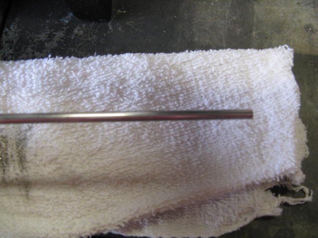

needed to make some new longer links so i decided to use some 3/16 hollow tubing that i turned down and ran a 4mil die on for threads. I decided to do this so i didnt have to run a grub screw in the rod end. these are for the rear still need to do fronts.

LOL.
Do you know how much lighter that tube was over solid? Looks like it could be a great way to have a pilot hole drilled and drill it out some more.
LOL.
Looks like 3/16 solid rod weighed 11g for bother and the hollow 3/16 that I used weighed 7g for both. This is without rod ends.

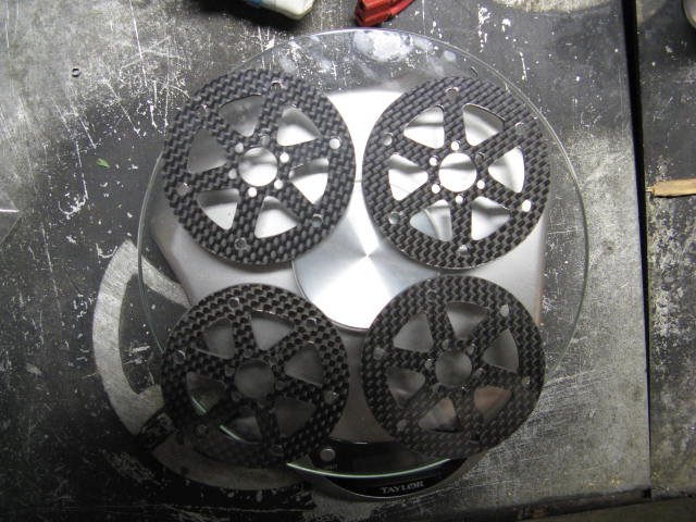

Got some new carbon faces for my wheels from DLUX. They are a great addition to the rig. Not only do the look cool but they weigh less than my solid faces by 12g. Thanks Erik for another great part. These arnt the best pics maybe someone will take better ones this weekend at the comp.

Looks good!
You will need to figure out how to get some spare motor cans so I can turn those down for you. I can feel a pretty big difference from the weight loss, especially where you're losing the weight.
Looks good!
Thanks Erik. I'll see what I can do in the motor can dept. Thanks again for the DLUX parts and the excellent customer service.
