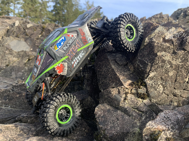

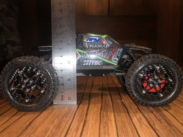

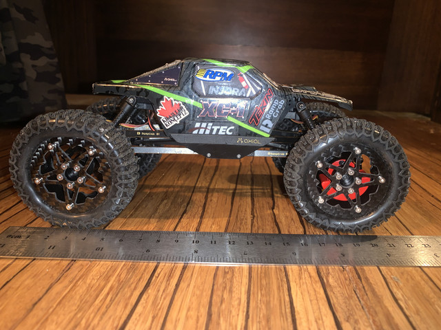

To start it was the basic tires and wheels upgrade along with high clearance links upgrades on the first three from left to right.
Mine is the black and green on the far right and will be the main focus of the thread. I am running high clearance links but also extending the wheel base (6mm front, 18mm rear). Found here. This kit is from Ramp Crab.
The Hi clearance links are from Injora (X003SOOPMF)

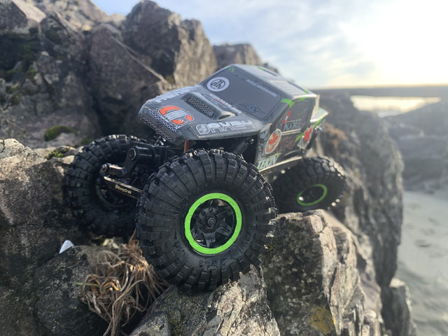

Next while I was having fun on this gorgeous bedrock at Incinerator Rock beach near Tofino BC (pictured), I rolled my rig into the tiniest of tide pool puddles. The smallest little splash, just a few drops really, managed to hit my ESC and that was the end of my reverse function. Now from time to time it refuses to also go forward.

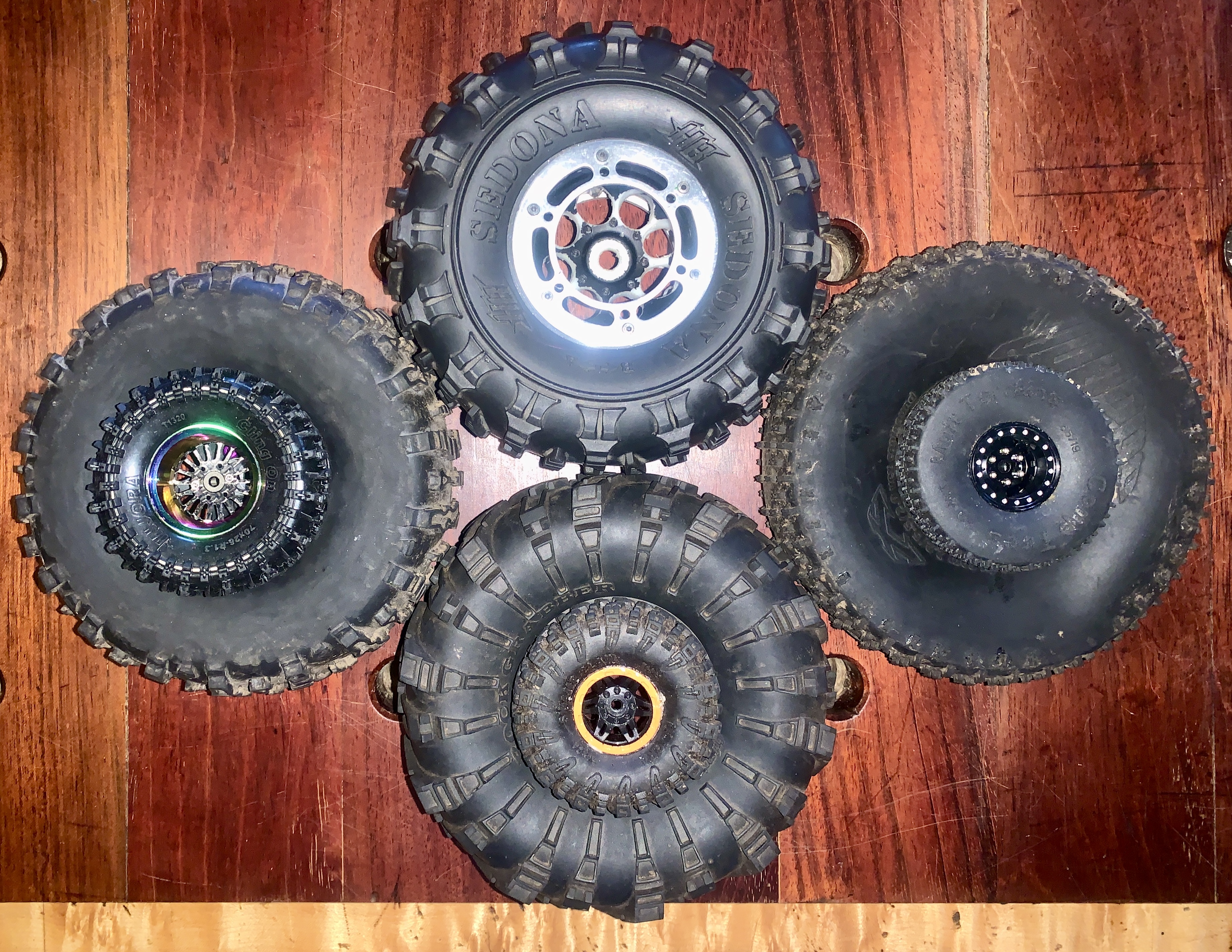

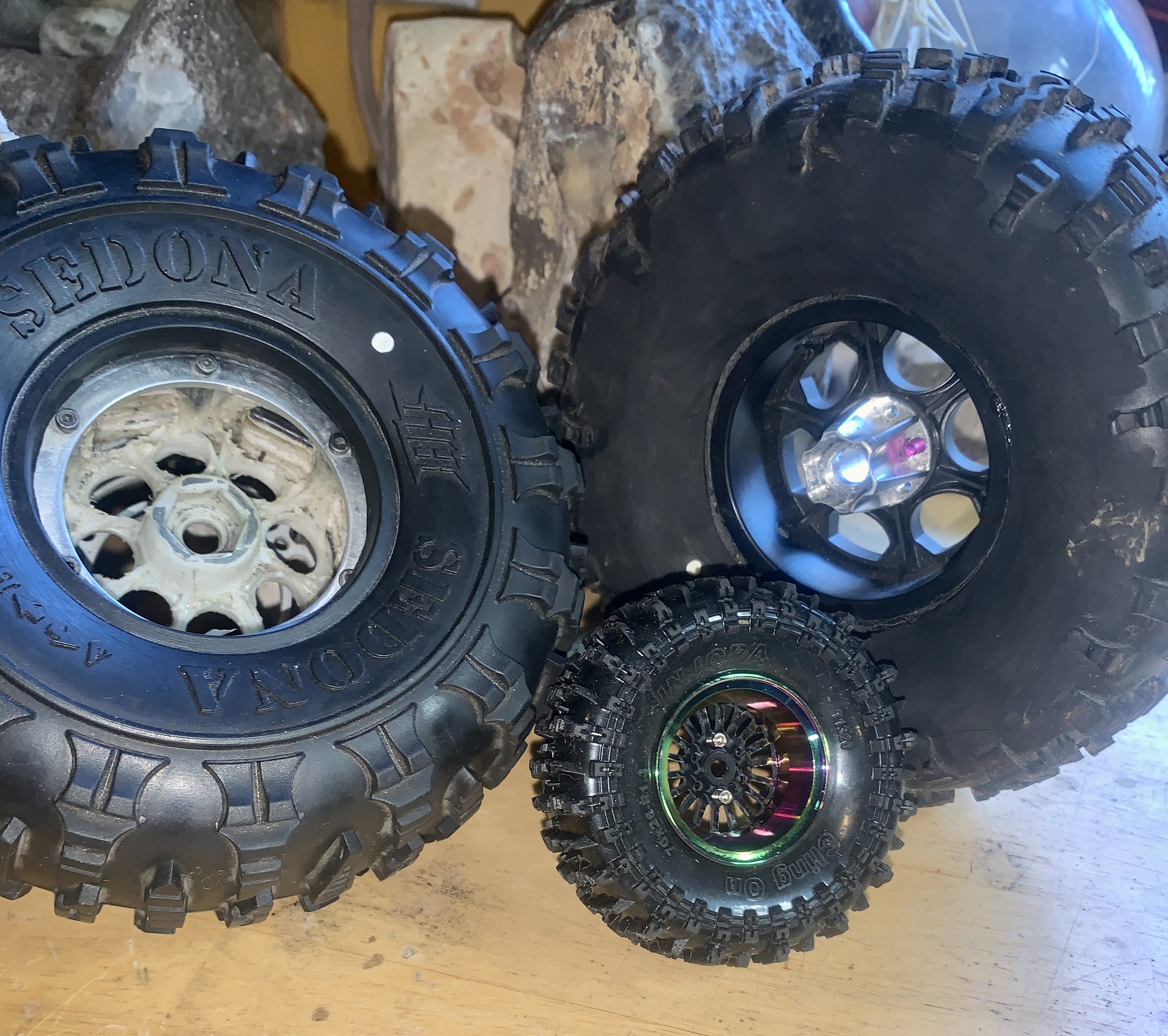

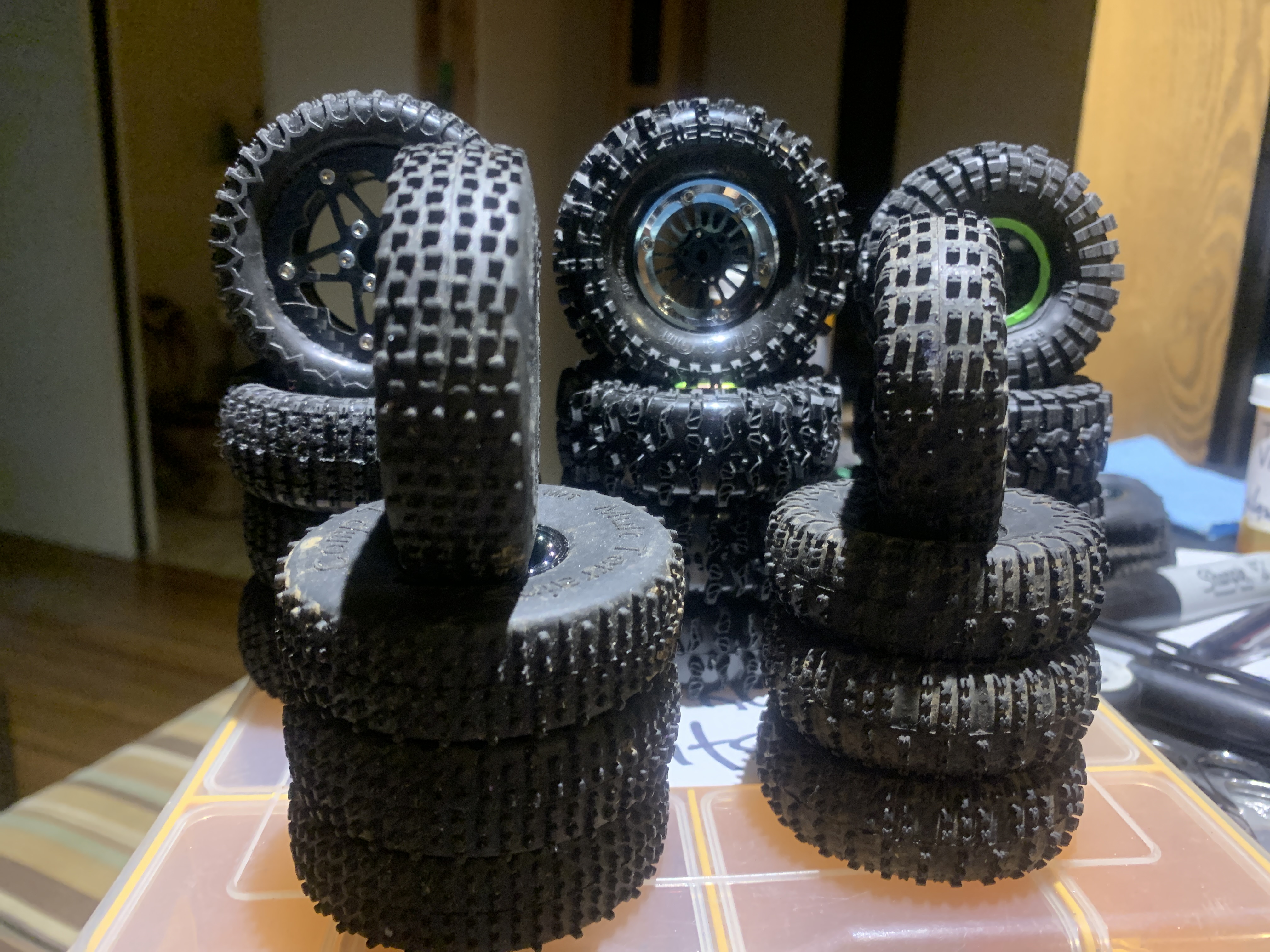

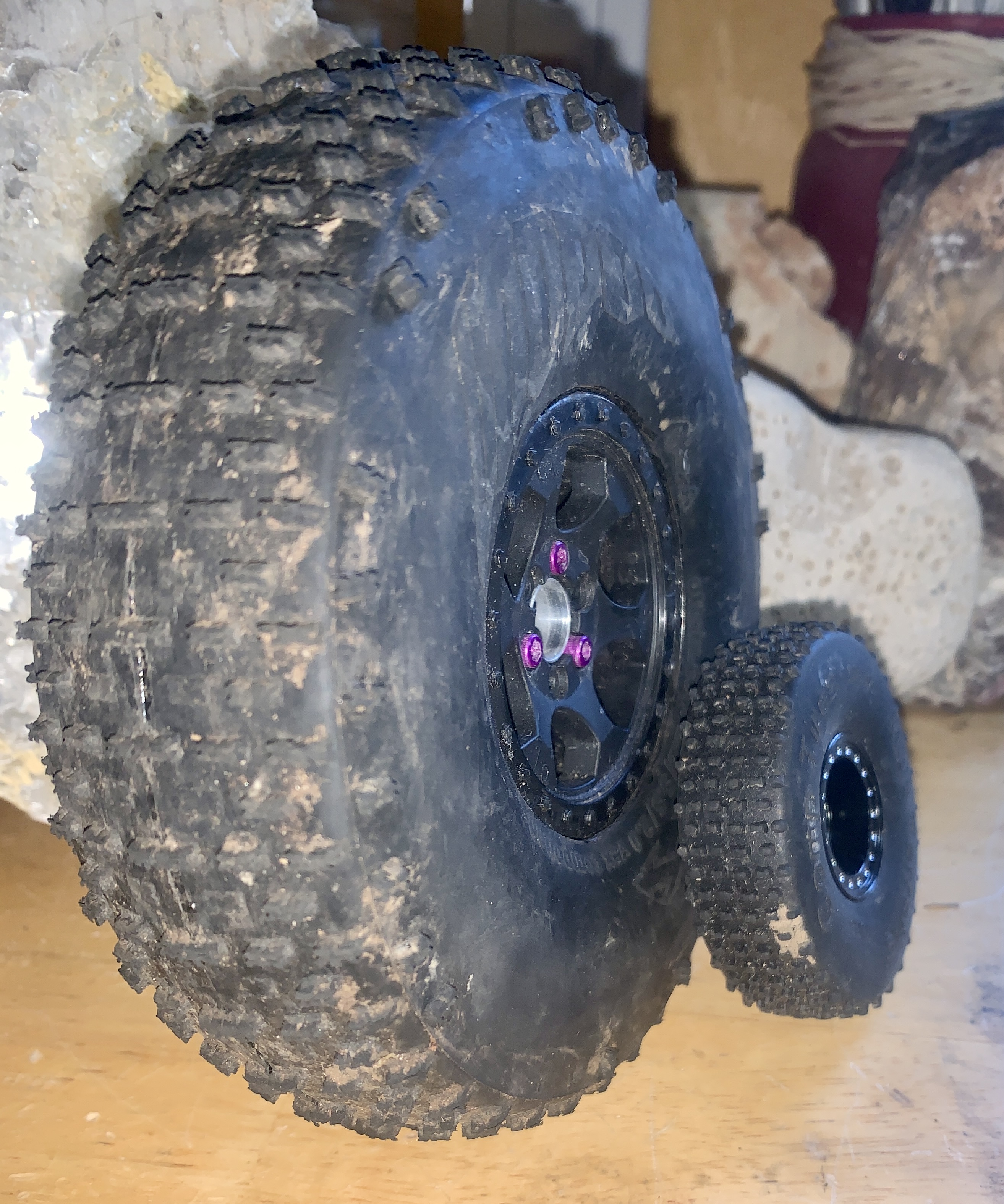

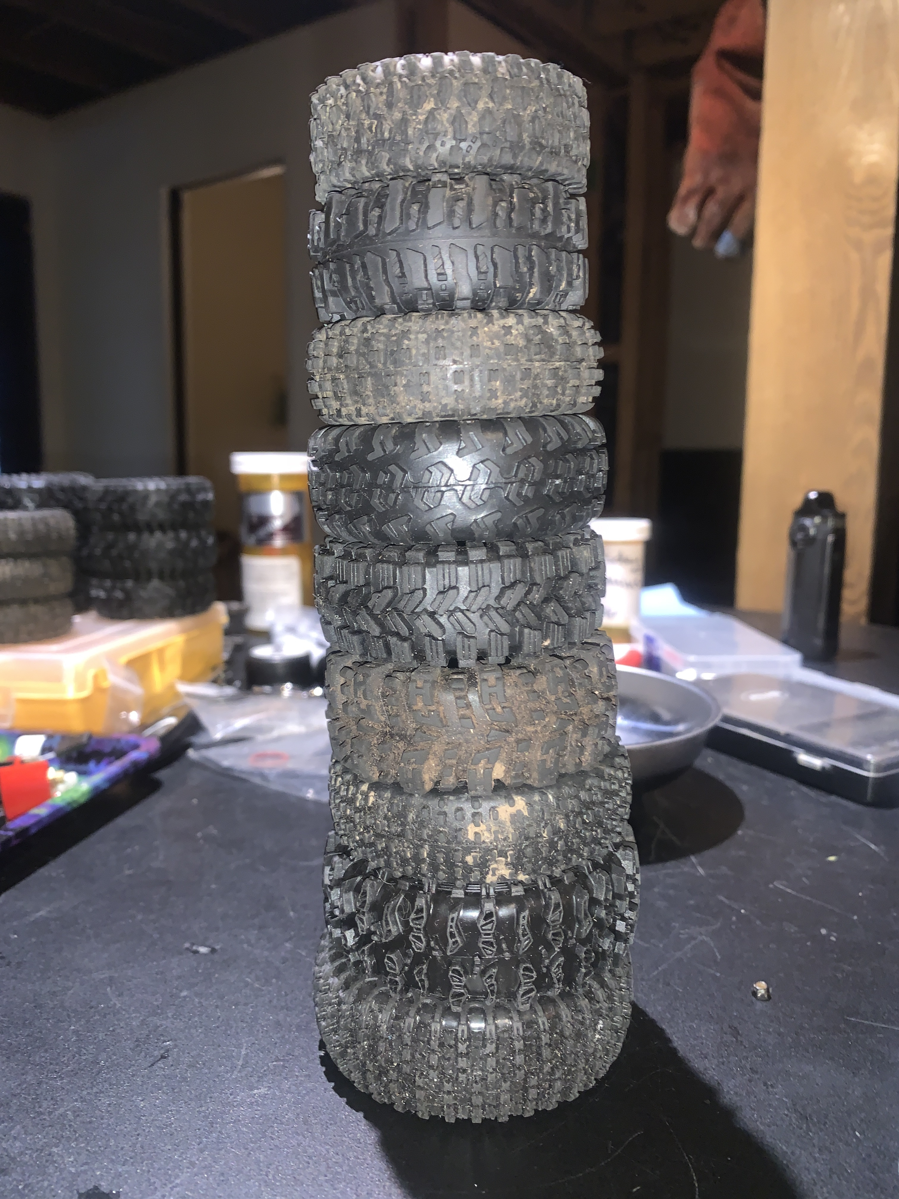

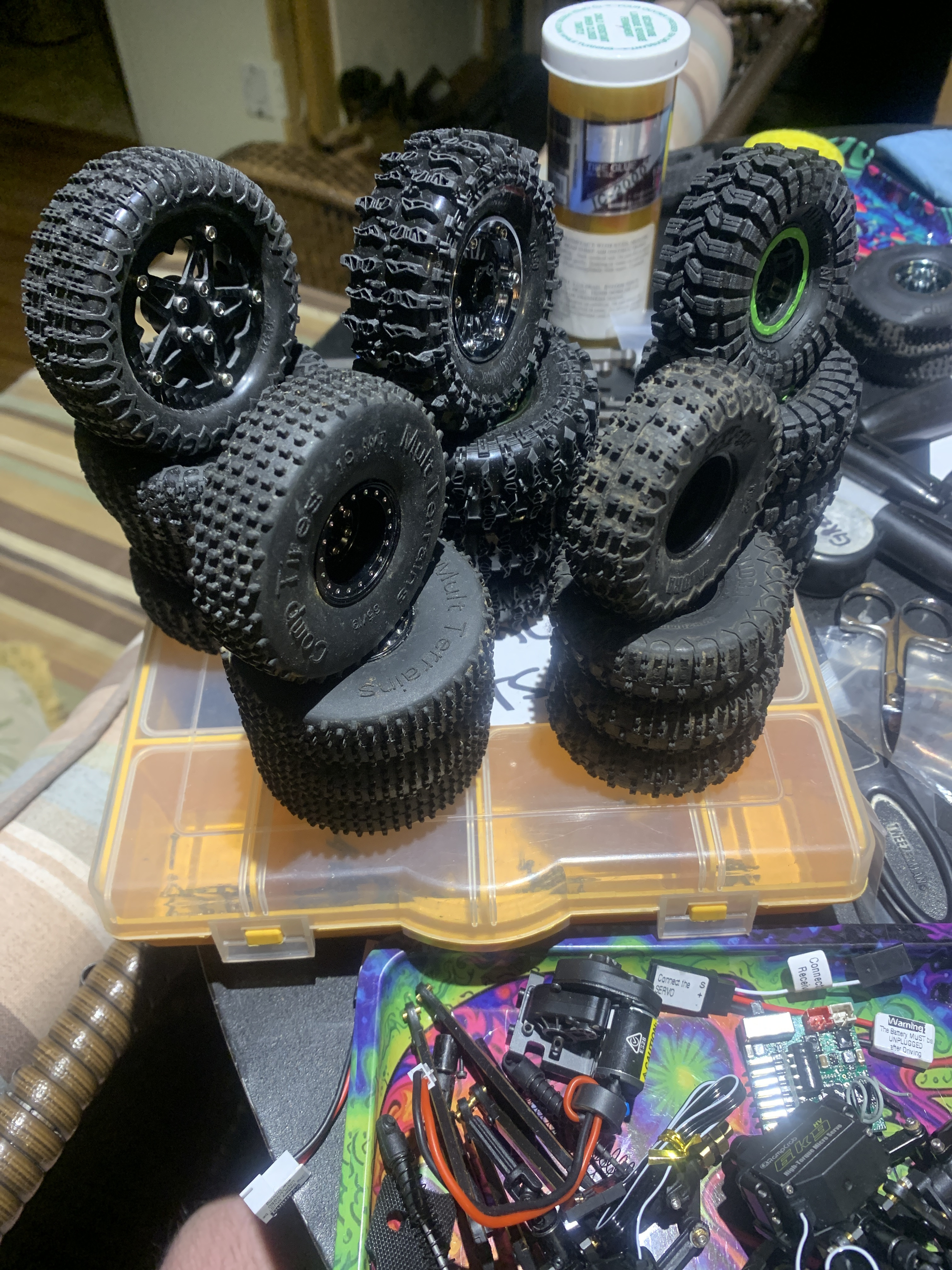

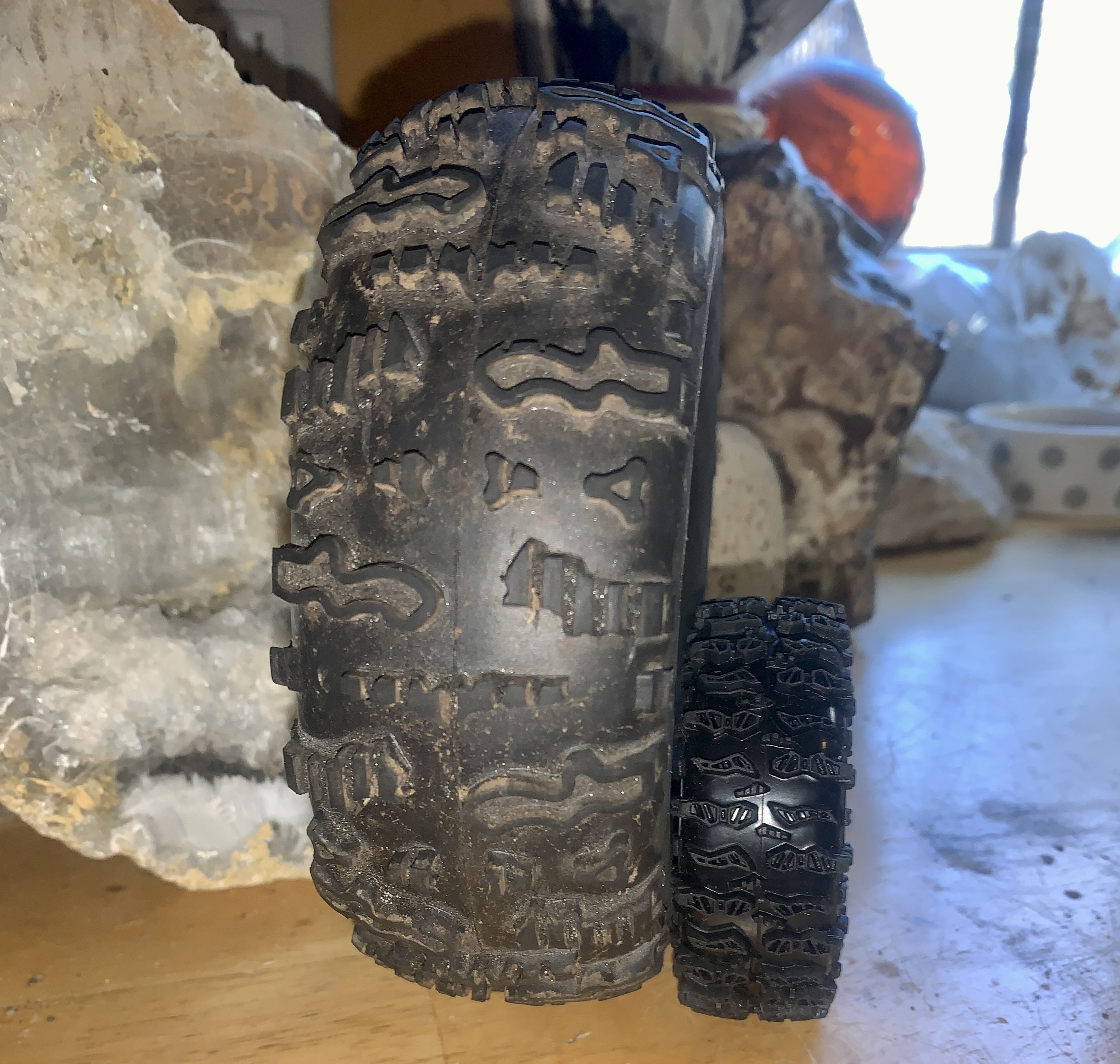

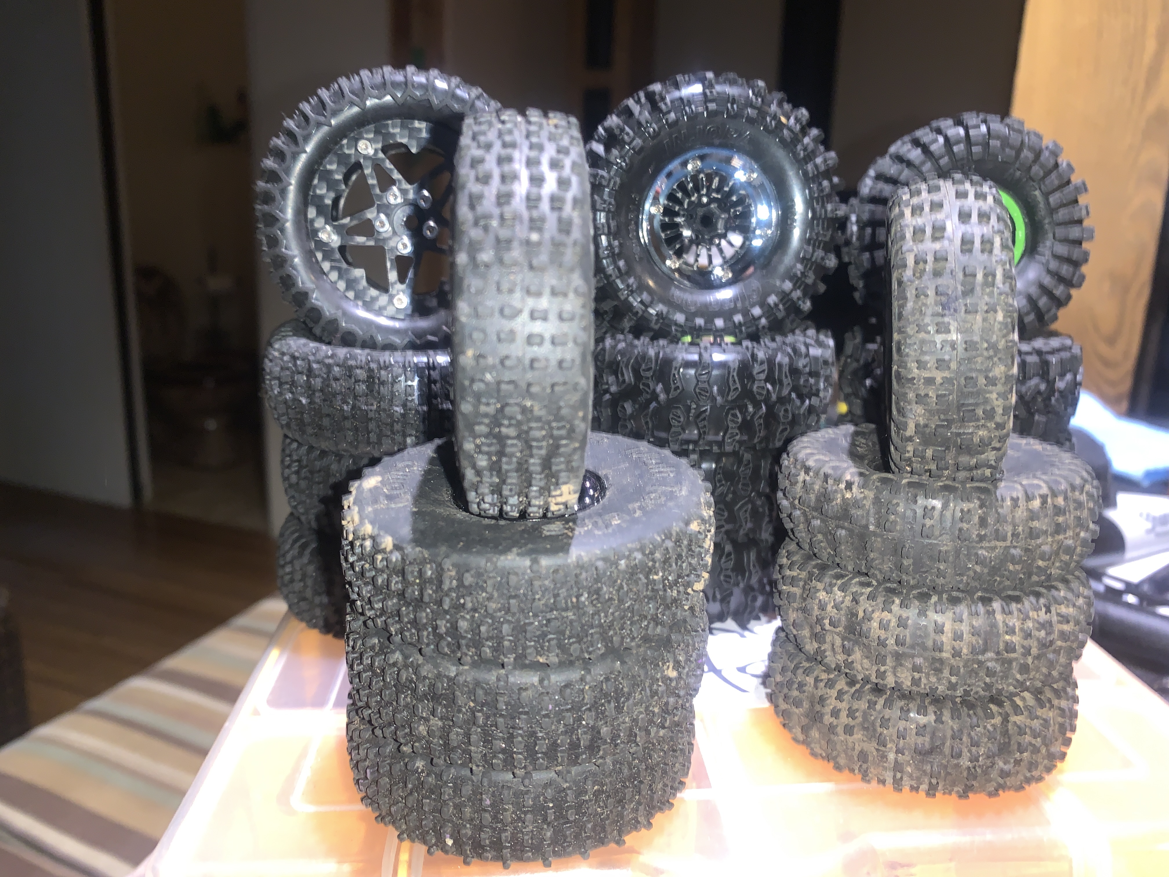

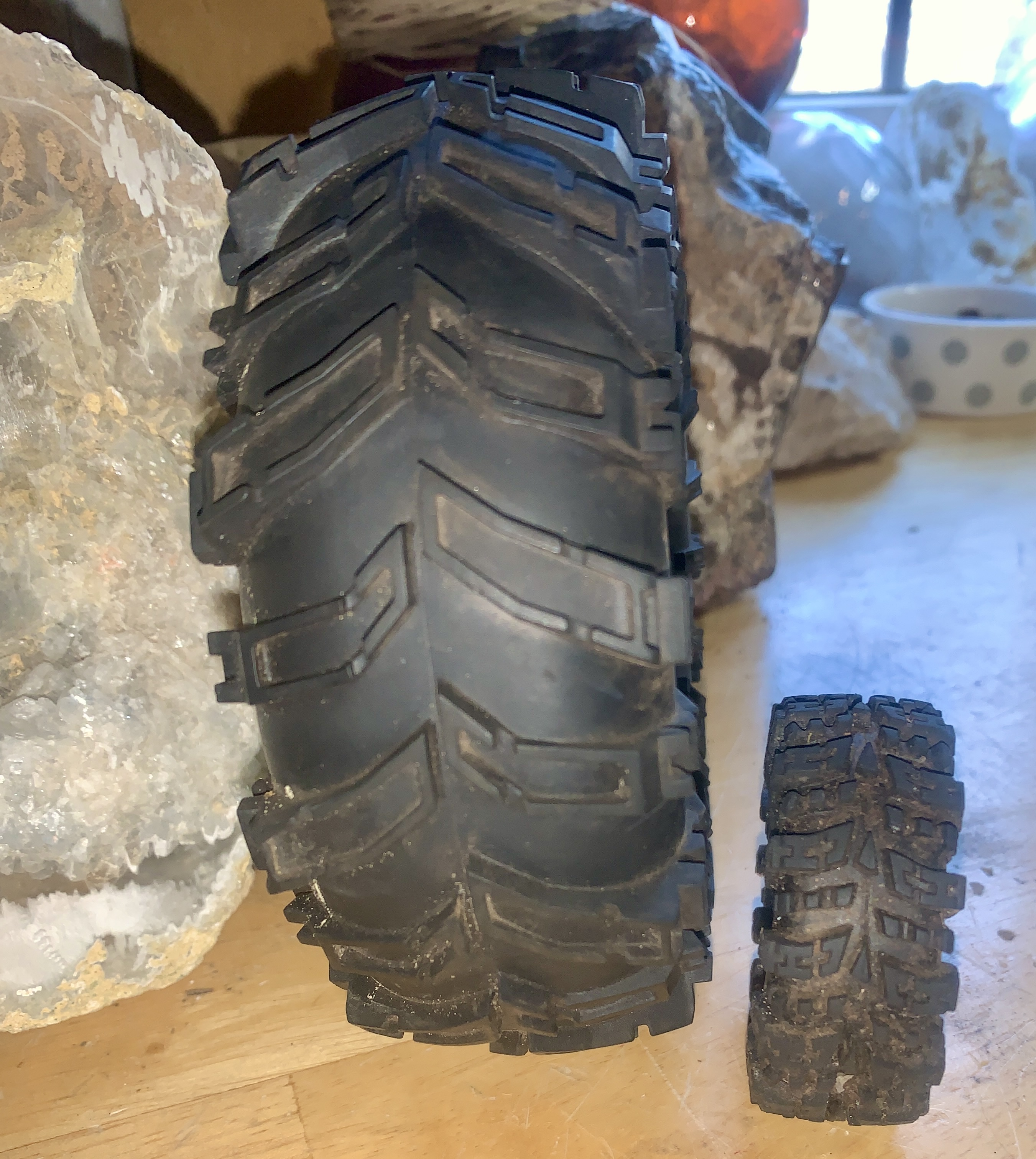

I grabbed a set of HUGE wheel weights 70g for super wheels Found here. Got some 1.8” CF super wheels (here) and ordered some oversized 1.3” pin tires to mount. Had to chop them up and do some gluing. Just like the old 2.2 comp voodoo days ahhhh memories ☺️. Those pin tires got a tread chop treatment as well and absolutely work swell. Only problem is now I am way too narrow and will have to get some brass hub extensions to widen my WB. But that is the way of it brothers. Mo’ mod. Mo’ problems. Mo’ mods. 😵‍💫😁
Many parts are on order. Lots of fun to be had. These AX24s absolutely SLAY btw.
If I can recommend tires to anyone the INJORA 1.0 Tires-S4 Multi Terrain Pin Crawler Tires are THE BEST hands down. Just like the Voodoos of old these are untouchable. I tried them for a bit before I threw my supers together and I LOVED them. If I wasn’t rocking mad wheel weights I’d be running these things. They are almost the same height as my super set up!
