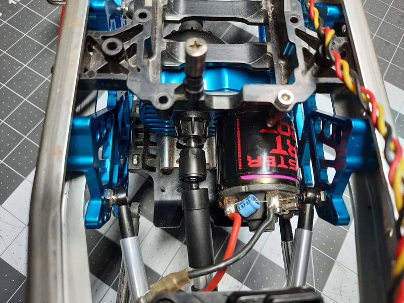

There's a 22t Kyosho Outlaw brushed 540 that's older than the hills hiding under there with a 24t pinion. I had a Holmes torque ring left over from a previous project so I slapped it on. No idea if it'll make a difference or not, but thought it couldn't hurt. Starting with a brushed/1060 combo on 2S for now until I get it sorted. *
