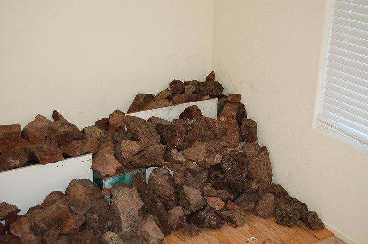

Front WK axle overall with tires is 10 7/8 and the rear axial axle is 10" overall with tires. My rig is coming along great and i will be taking some pics along the way during the final build. I don't think it will be legal for comps but for me its about fun times with my son, we even started an indoor rock course in what used to be a formal living room that never got used! (my wife is still warming up to the idea)
