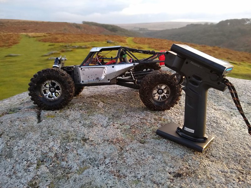

I got this used off ebay a couple of weeks before Christmas. A strip down revealed a tired brushless motor, everything else was ok, just a bit scruffy and needed some loving.
I looked around for upgrade parts to get, mostly for steering and front suspension.
Picked up a Scorched parts rc steering, shock mount set up and rear upper link mount. Both are 3D printed and good quality.
After 1 run I swapped the esc and motor for a hobbywing 1080 and 45 turn Tekin brushed motor I have had sitting around for a while.
I cut the old battery tray down just to hold the esc.
Not much room for a receiver and BEC, so cut a piece of 2mm abs sheet to fit under the shift servo.
BEC is a No Brainer from Heyok set at 7 volts. The PowerHD servo seems ok at this voltage.
I made my own battery tray to sit on the left side using the old steering servo mounts and longer screws through the lower track arm mounts.
The tray is made from delrin. Machined the underside out because I could, no real reason to do it lol.
The screw holes were drilled 2.5mm and just longer screws used which tapped themselves into the bottom of the tray.
2 old body posts and another piece of delrin to hols battery in place. A 2200mah battery will fit in through the side window easily.
I didnt have short enough shocks to use the Scorched parts mounting position, so found this old shock mount off some buggy I used to race. Drilled a couple of holes to fit the mount.
95mm Gmade XD diapragm shocks with internal limiters. Couple of small 'O' rings under the piston.
2nd Drive out I lost part of the rear driveshaft. I replaced to whole thing with a Junfac from my pile of about 1000 of them.
Drove it a couple of times with the wheel/tires it came with, but the wheels are plastic and hexes on 2 of them were stripped when I got it.
I took the Gmade wheels and MT1904 tires off my K10 to try. The MT 1904's work well in the terrain I drive in.
More parts to modify the front suspension and diff arrived today. The locked front diff will be unlocked and will try some diff putty I got from RC Mart.
More to come soon.
