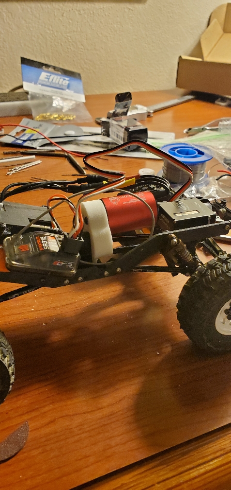

I already have one of these in my Showtime bouncer with a GamyRC motor plate, 12t pinion(IIRC) and a Lizard ESC. It's fantastic at low speeds and has pretty good wheel speed as well.

My motor choices 2030 surpass 4500kv

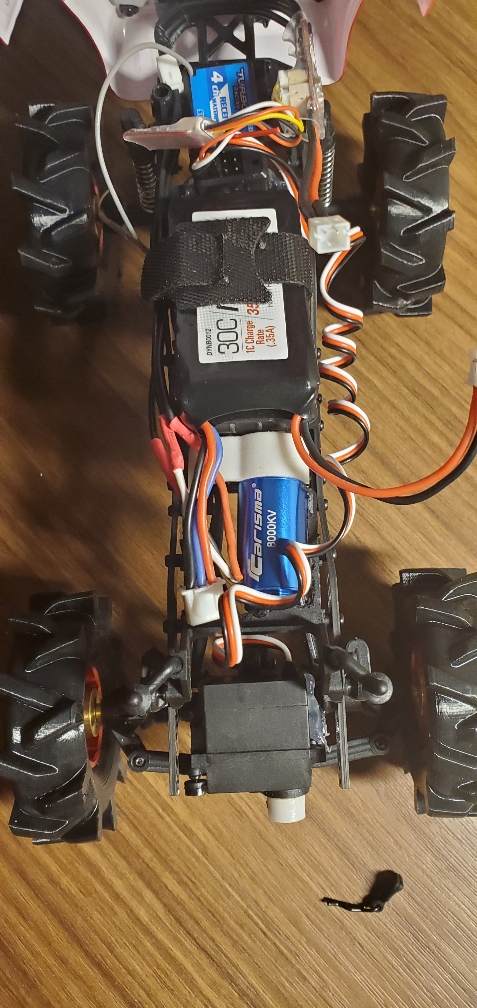

Carisma 130 size 8000kv
