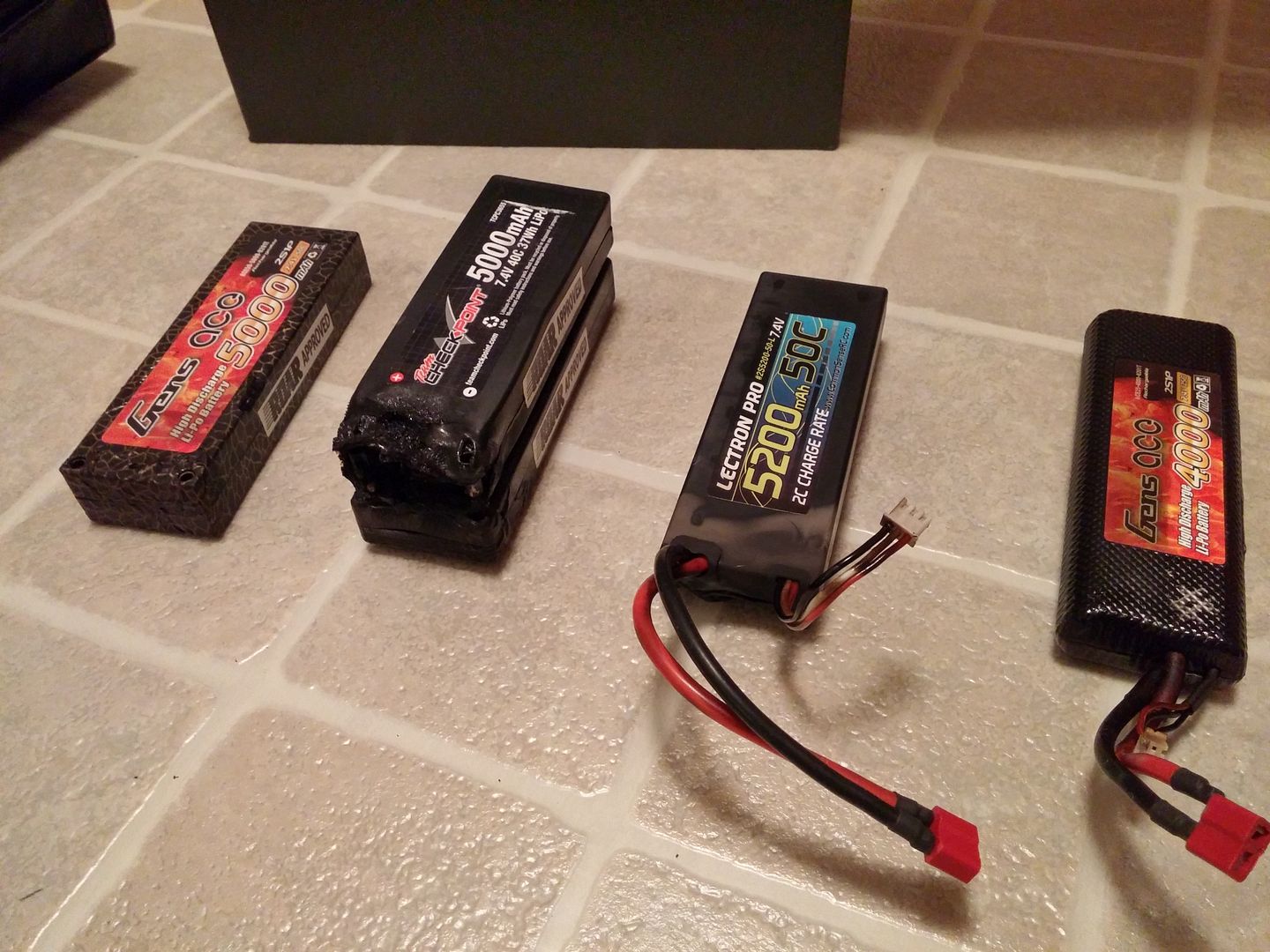

A look inside...

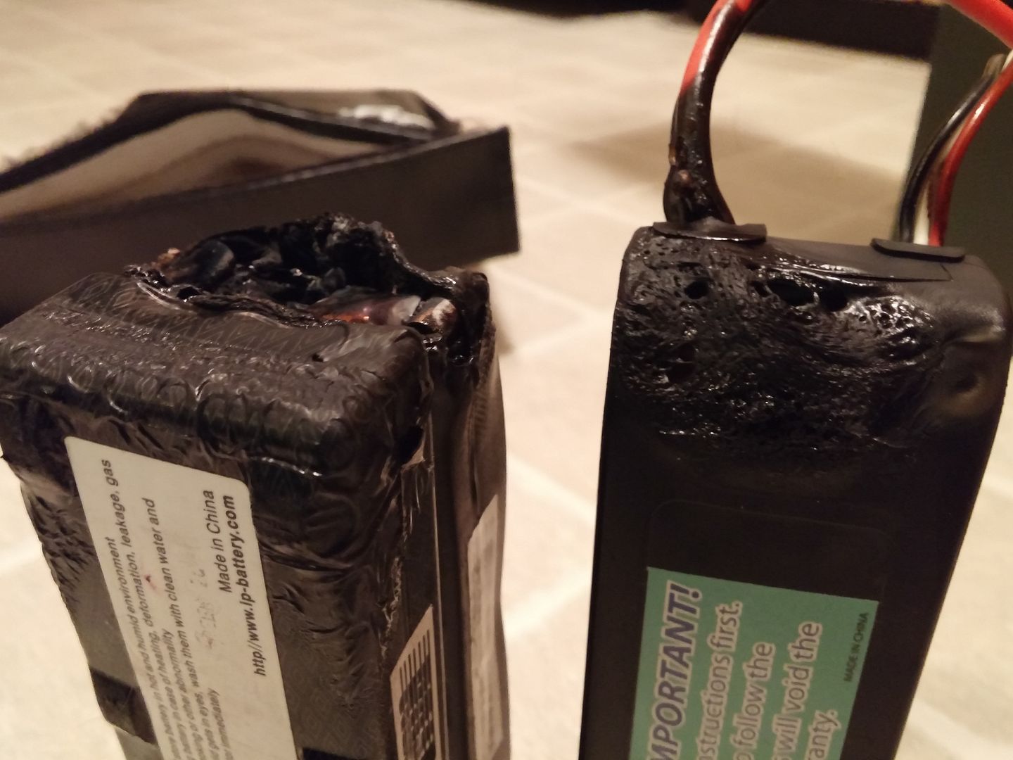

They were stacked in order with left on the bottom, and the right on top. And yes, those two are melted together!

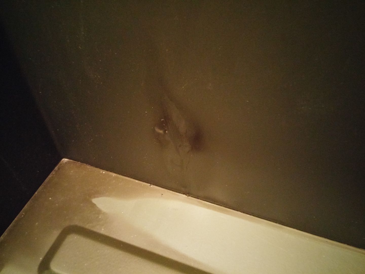

The can held up strong. I don't have any concerns reusing it once it airs out. It does have some character now though.
The outside of the can... No damage.

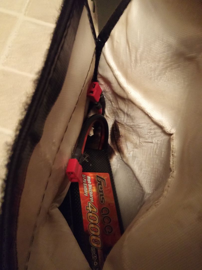

What about the lipos in the other sacks? Not a scratch, not even on their bags! Since the folded-over side of the Dynamite bag was facing the others, the fire would have had to go through 3 layers of the bag.
I'm pretty good about caring for my lipos. Those batteries were all put to a storage charge, and checked as recent as a month or two back. Nothing in the bags to touch contacts. It appears to me that the fire originated from one of the two post style batteries that are fused together, but I have no idea what triggered it.

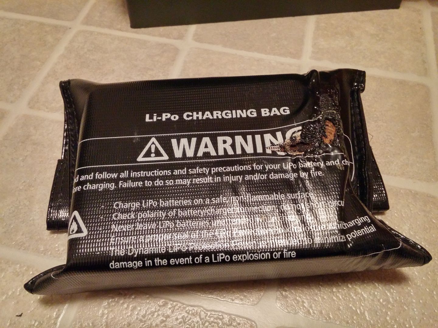

I would also like to add that I don't think anything less of the Dynamite bag. It's the thickest bag I own, and I really think it was best suited to withstand the fire. It does appear that it contained the majority of the fire, but clearly some the heat got out and would have potentially caused more damage if it wasn't in the can. I'll probably start using cans for transport to the comps as well. I just hope the park rangers don't get spooked!:ror:

The Common Sense bags in the pics are almost as thick as the Dynamite bag that burned up. I don't know if either is a better, as it's possible they may have a different composition. I'm not aware of any fire ratings on these bags, but then again I've never looked for it.

It was probably a cell that was slowly venting, and one day just didn't have enough electrolyte and began shorting internally. I've seen a few fires happen in storage, and it was always a hard cell lipo pack. I think they are more dangerous because you can't see the puffing, and so they just burst a seam and vent out the good stuff.
