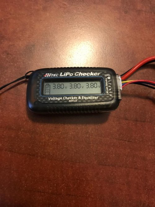

This is a great, budget friendly tool to do quick checks on LiPo balances.(roughly $20) I use the chit out of it. If you're out of bounds, just leave it plugged in to a pack to bring your balance back."thumbsup"
