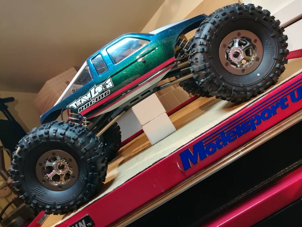

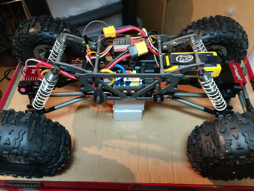

1080 with Paradox stock 50x1,14t pinion on 3s.Dig box is serviced and back in but hes running a DX3s for the time being so no servo is in for now.
Im so impressed with it that ive taken the Mamba X/Slate combo out of mine and fitted the Peak 50 single and another 1080......
Sent from my BLN-L21 using Tapatalk

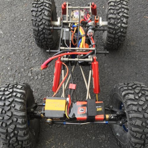

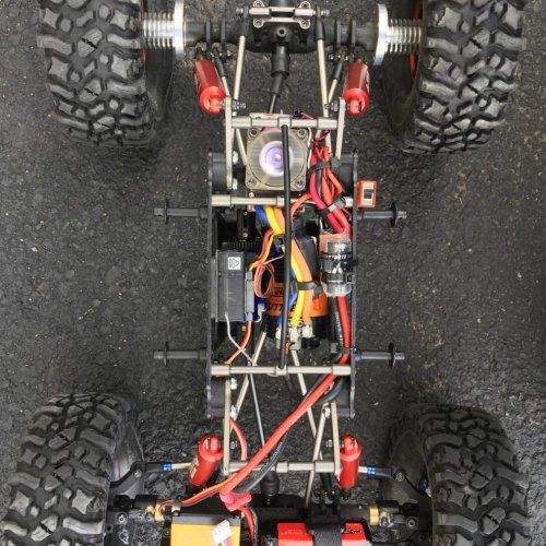

VP Ti 105 & 120 x3/16 links
VP Ti 150mmx3/16 steering rod
Losi 90mm sst rod custom bent for drag link
Novak The Goat 3s esc.
Novak Ballistic 18.5t sensors motor set at 15deg timing and 16t TLR pinion
Savox SA-1230SG servo that’s 500oz. in @6v
Castle Creations external BEC 6v. Rewired with bigger ga. wire and shortened tx side 4”
Yeah Racing 120mm internal shocks limited 10mm inside with the heaviest spring . No limiter straps on it yet but think I’ll put 115mm straps on them
VP DHII with 475 hub
VP SLW V4 with 600 hub
Pitbull Rock Beast 2.2x5 5/8 comp compound
CodyBoy Designs front steering mod axle
Hot Racing trany center housing,lower mount,front gear brace and gear set then I did the gear mod on that.
Krazed builds front battery plate

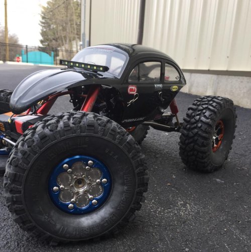

Was out crawling with my kids. The body is my beater body. Samuel S Lewis park near York Pa

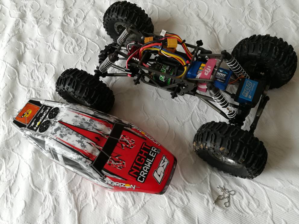

LOSI Night Crawler has always been my favorite Chinese puzzle (I think they are made in China??).

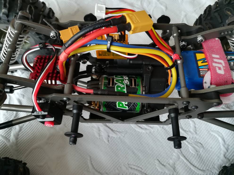

I think I finally can call this Losi NC "not stock" - I have removed the upper electronics tray and neatly stuffed it all inside the middle, added servo weight and a 15t ARMA buggy motor on 3S. It's LOW, lighter, weight forward and faster for sure... now I just need some REAL rocks to test / tweak it, and I may have to replace that body again; kinda went Edward Scissor-hands on it.
