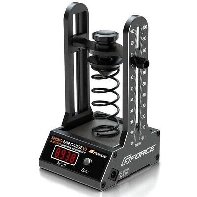

JimrC, there are but not knowing the material and the spring rates being so light and close between jumps means my calculation could be off enough that calculating them is really just a slightly educated guess.
I've started doing my own spring rate checks by putting the spring on a small scale, zeroing, then compressing it as close to one inch as I can by hand/eye and ruler. At least I can do this with springs with a known spring rate and compare results to unknown rate springs. Close enough for me for now.

There are RC spring rate testers like this one from G-Force:
Or shock equalizers that you could use to find similar spring rates.
Hot Racing: Hot Racing Shock Tool & Spring Gauge [HRASD188C]
Losi: Losi Shock Matching Tool [LOSA99170]
RPM: Shock Duplicator - RPM R/C Products
Yeah, I've thought about making something like that rate tester for the kitchen scale from some lumber scraps, a ruler and some nuts and bolts. Couldn't justify buying it though.
My corner balance set up is 4 cheap digital kitchen scales from Amazon Velcro'd to a board and an Excel spreadsheet calculator. So it would fit right in.
