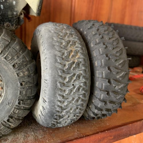

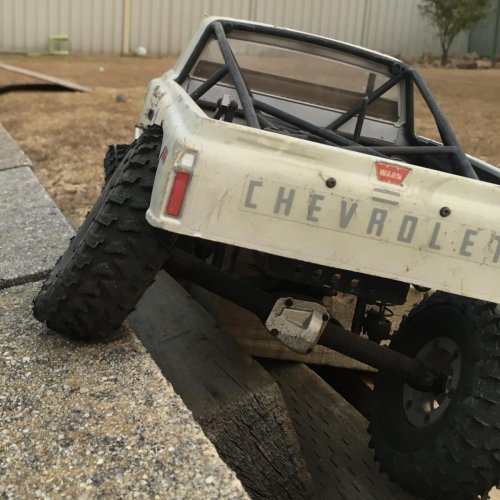

I have tried the X4 in red compound, tyres are very stiff, heavy sidewalls, but fold over on side hills and tight turns with soft foams. Currently running closed cell foam with a decent air gap, they don’t fold over much now and even with a big air gap to the foam still don’t flex or squish much. Compared to other tyres I have they are on par in most places, just meh in others.... always thought about sanding the heavy internal ribbing off the inside of the sidewalls. The red seemed to wear pretty quickly too.
I still think you wear out tires like no one else, my friend... awesome pics of destroyed rubber!

Holy cow you wear out tires! I get bored with a tire before wearing them out. :ror: I also must not crawl enough, but the rocks here on the East Coast aren't as abrasive as in some other areas either.
I'm OK with fast wearing tires if they work. But the red appear to kind of "chunk" like RC4WD tires which I can't stand.
