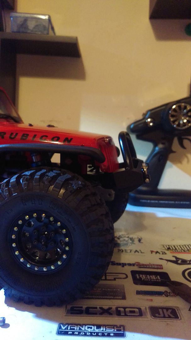

Got the body lowered and mounted. Ride height is about where I want it
Mounted up the fender flares. Servo and super lift steering link. Adjusted the panhard bar. Stretched the wheelbase to 11.4. Remounted the front bumper to allow some approach angle.

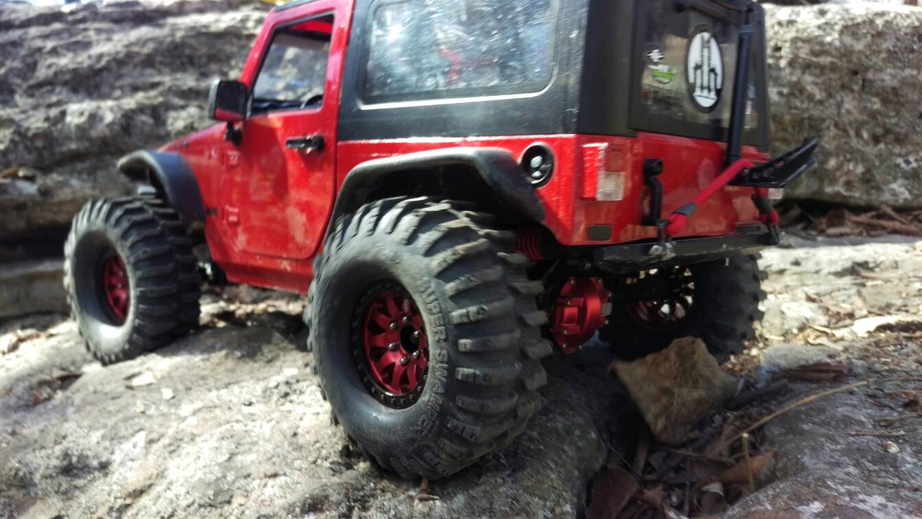

She's officially not a shelf queen. Ran my little ole 1300 though it around the neighborhood. Not much rocks but it's a pretty balanced rig for the weight geared it at 16/87 and the motor barely got warm. Meant to take more pics
