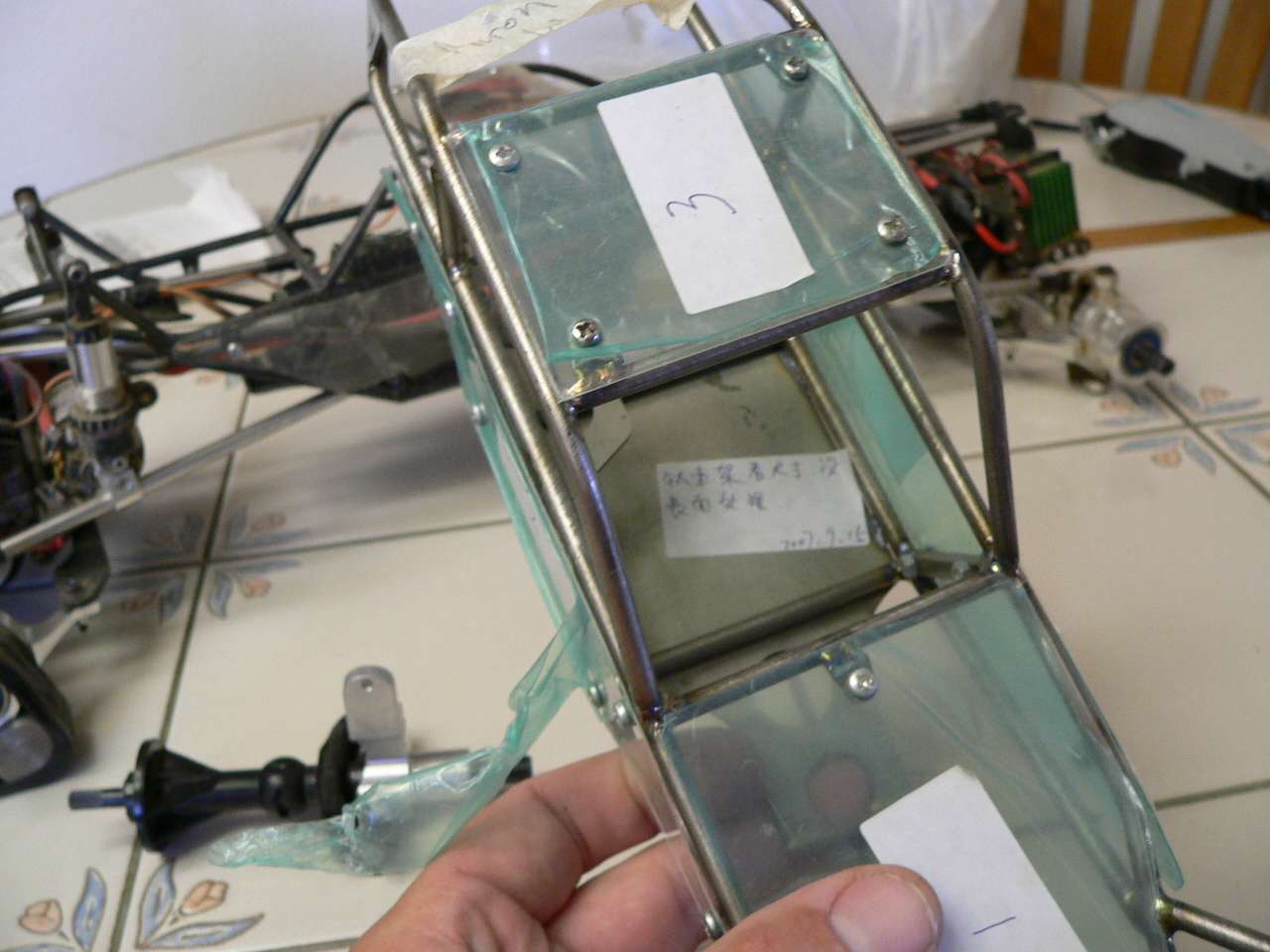

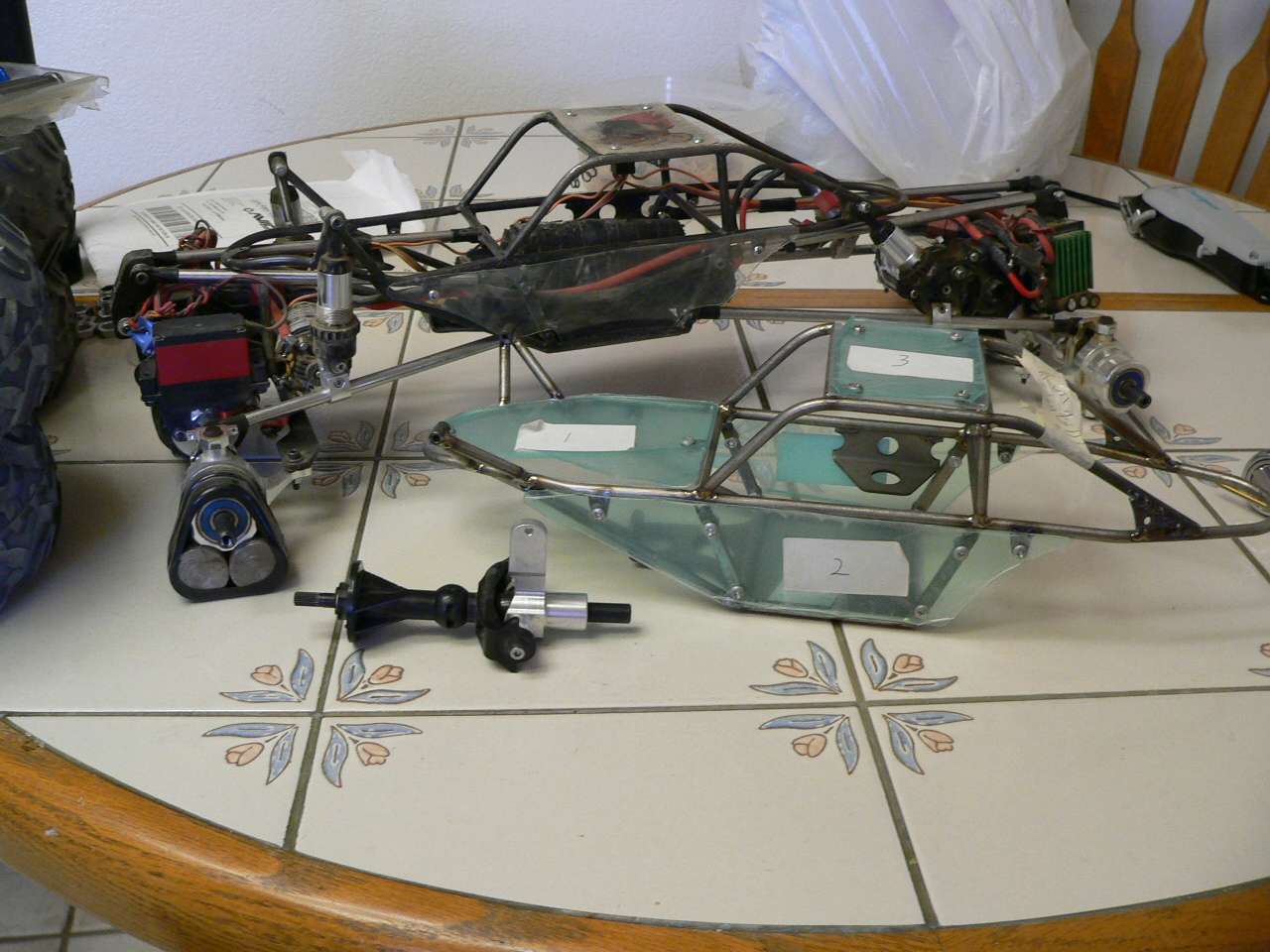

Beside a few lil changes I will be running close to the same setup my Super Hustler has ran the last few years.
1st main change was the chassis
After 4 HARD and ABUSIVE years I finally bent my Original Hand Built Hustler Chassis.
built by Aaron Dusenbery, TEAM CARNAGE CREW. Distributed by RCP Crawlers.com
So what could be Stronger then a DOM Tubed Hustler......... One made of Titanium
I believe this to be the ONE and ONLY Titanium Hustler in Existence.
The Base for my 2011 Super Class Rig.
2nd Major Change will be Zero Ackerman Steering Knuckles.
The ONLY way to MAX Out your steering for ALL wheels is to run Zero Ackerman.

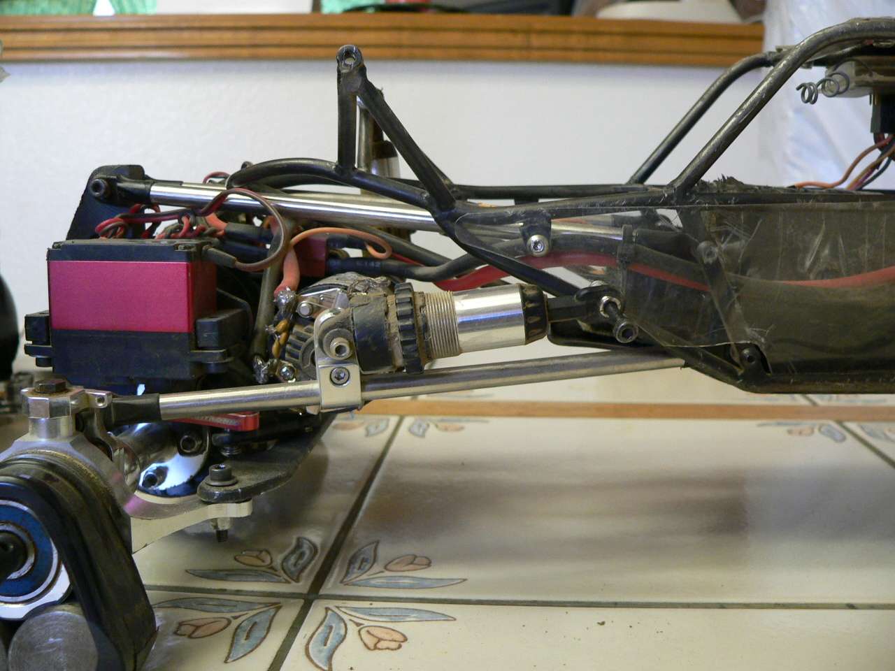

Some Specs
Chassis: Titanium Super Hustler. One of a Kind
Radio: Spektrum DX7
ESC: Two Castle Creation Mamba Max's
Motor: Two 35 Turn Integy's 6t Pinion's
Servo: Two JR 8711's with a Castle Creations BEC per servo
Axles: Tamiya Clodbuster, Metal Gears, CVD's, Old RC4WD Knuckle's reworked with Custom Zero Ackerman Arms
Wheels: Axial 40 Series Beadlocks
Tires: Proline 40 Series Moab XL's in the OLD M2 and G8 Compounds
Links: Stainless Steel by MTR
WB: 17 7/8"
Few Pic of my Progress
Anyone want to Translate for me.
The Bending ........... This can't be good. Ask me how I did this if you haven't been watching.

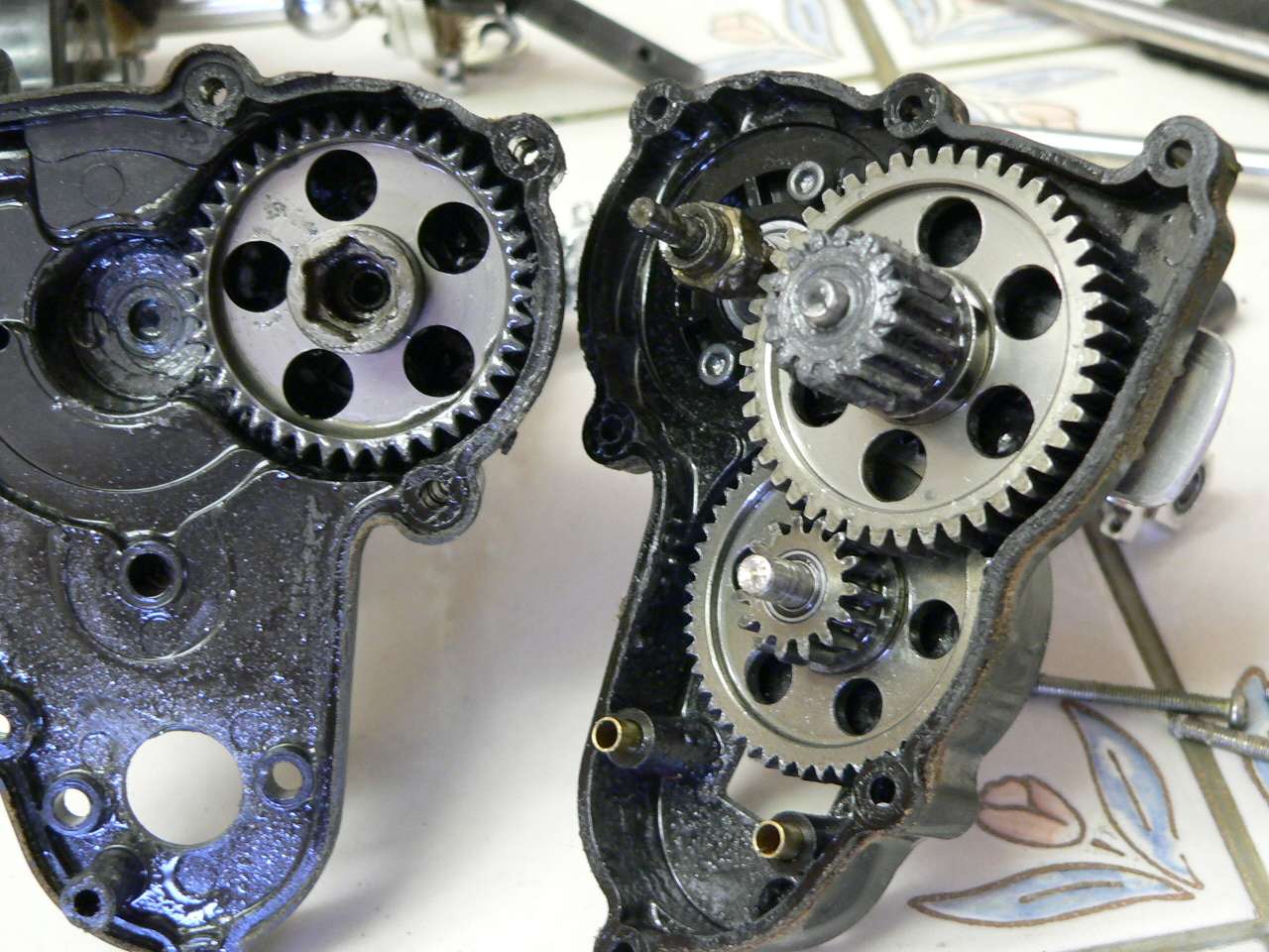

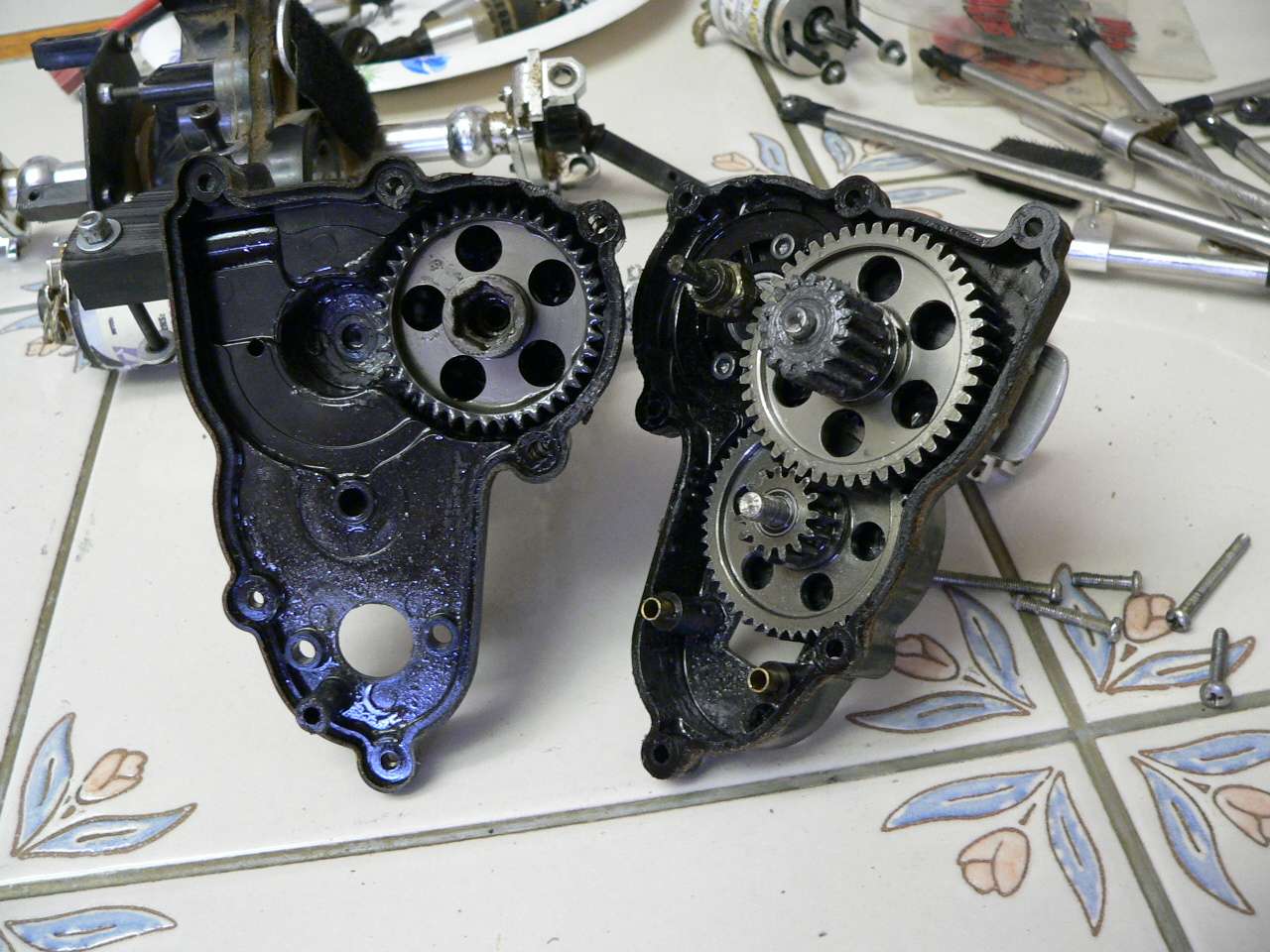

Metal Axle Internals should be good for another Season
and Striped Down for maintenance

How much steering angle do you get with those axles???
I'm looking into buying some.
Thanks!
*edit*
Correction, after checking the CVD's I find that they are getting 40 degree's.
I chucked CVD in Drill Press and put angle finder on Axle Shaft.
*edit*
Here's a OLD RCC Tech Thread
The Thunder Tech CVD's get about 32 degree's
Get the maximum steering from your clod axles. 6/15/07

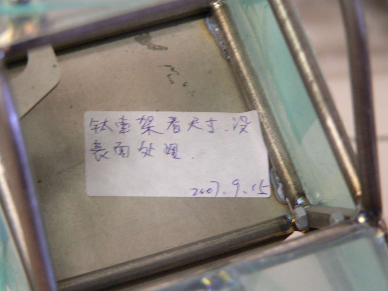

Looks cool! So some Chinese guy built that chassis back in '07?
When RCP was having the SE Edition Hustler's made they had a chance to have this Ti Hustler made during that time. The Cost of building more than this One in Titanium wasn't justified, but was a Nice Display Piece for the Shop. Took me 3 years to get it in my hands. Thanks Again RCP!!!
I remember that chassis. Nice score! My GenU- wine Dusenbery chassis is still here and looking good. Although hasn't taken half the beating that yours has!
