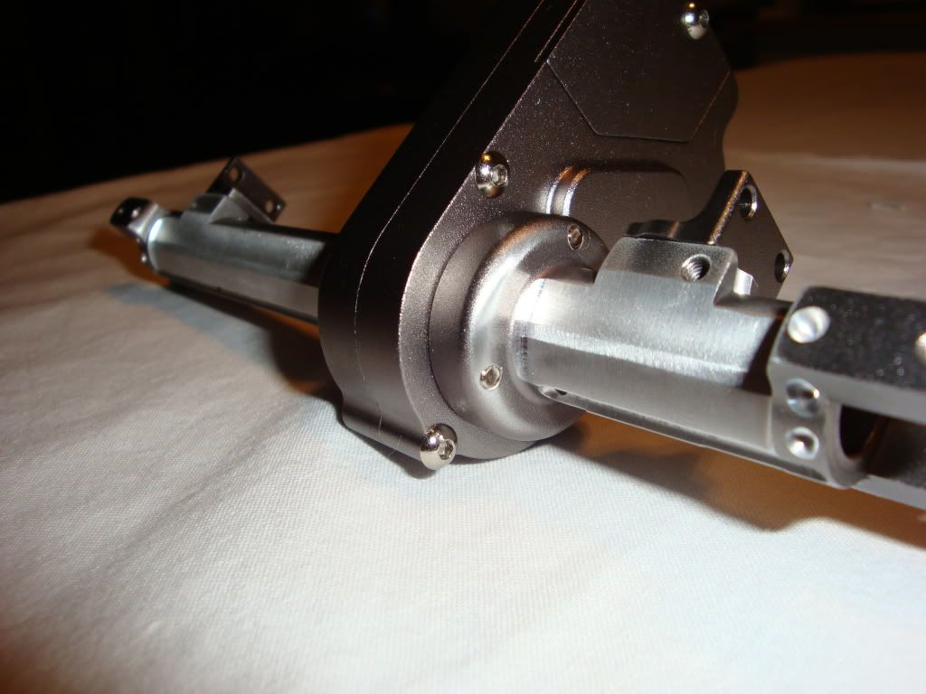

Next up......axles!
These are not finished yet. Again, straight from CKRC and into the machine.
Fluted and shaved tubes.
Lightening holes for the gears.
So far 1.5 oz off each axle, weighed complete less hexes and pins.
For example;
Long tube bare weight
stock 121.5 grams
Mod'd 92.5 grams
Short tube bare weight
stock 68.0 grams
Mod'd 56.0 grams
Main gear
stock 11.3 grams
Mod'd 8.9 grams
I still have more work on these axles but now you probably understand the OTT.

Thanks guys, every little gram counts and they add up fast.
Not sure on a chassis yet, I'd like CF, so yes to answer Nova's questy....as light as it can get without sacrificing reliabilty.
The tube wall thickness is .160" stock. I could have machined more then I did safely, I think.
Scott, the flutes are only over the top, (did I say that again?), the underside is shaved. :mrgreen:

Yes, but now he has more control over where the weight is. I have also found that lighter Bergs, especially in the rear end are climbing monsters for example. Vanquish wheels with no weights added in the rear is still too heavy IMO.
