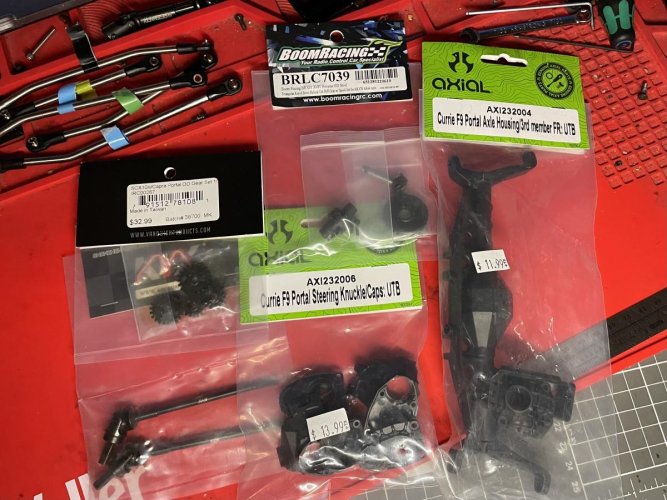

Got all my cheapo parts together (except the incision OD portal gears). Just waiting on hardcore rc steering links, and I'll have everything I need to play around with rear steer.

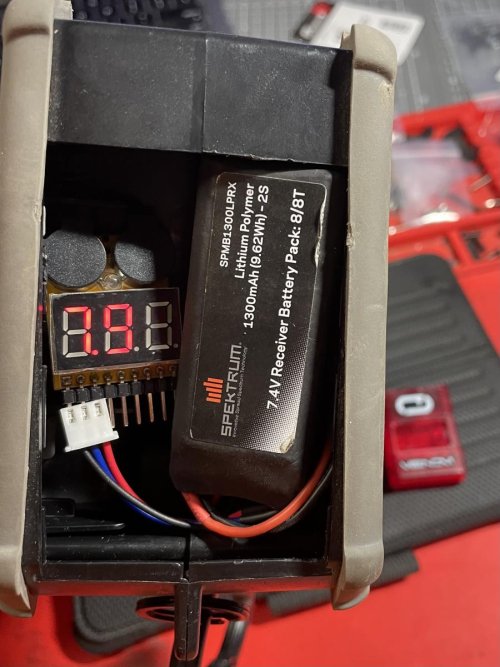

I use a 2S 2000mAh in my DX5 Pro and battery life is excellent.
You can use 2s lipo or life instead of 4AA batteries. Just take the sled out and cut the wires then add a battery conector.
