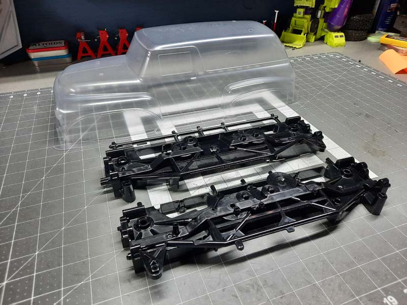

The stars of the show. The body is cool, though it certainly is a bit odd. Interesting the wheel wells were already trimmed out. That's a first for me on a Tamiya kit. That huge chassis is a work of molding art - huge and complicated, but fits together perfectly.

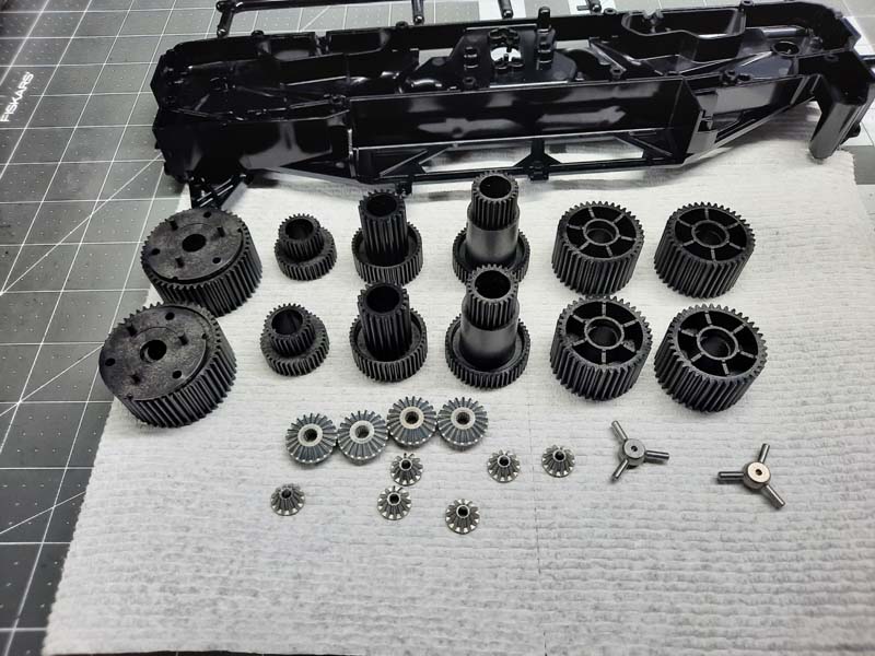

Gear porn.. Thick and chunky gears. No worries about durability, I've had some Tamiya gears in runners for over 20+ years now.

Lots of 5x11 bearings later, we're looking at this stack of gears. Not quite as impressive as the Dynahead, but still pretty cool. And a quick note about Tamiya - they just do things their own way, and don't give an F. I mean really, who creates a chassis like this for a 4x4 RC? And calls it a Squashvan? :mrgreen:

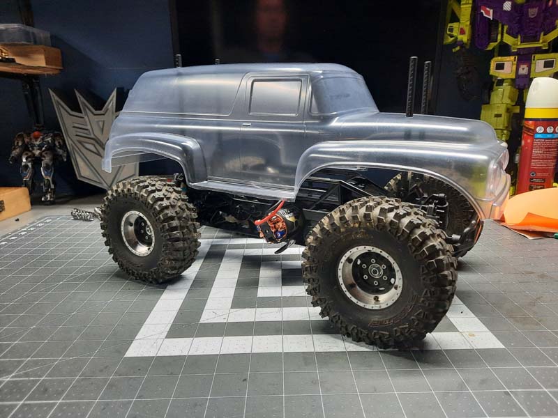

Went with a Reedy 5 pole and a 17t pinion to start. I'm sure I'll need some gear reduction somewhere eventually, I'll test drive it first once I figure out wheels and tires and see where it's at.

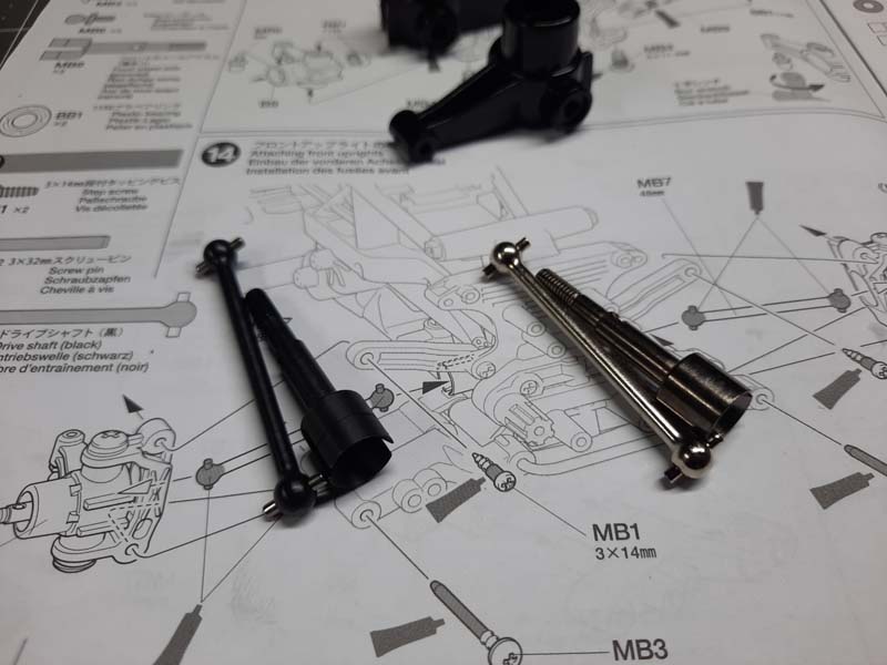

Interesting they give you separate dogbones and axles for the front (left) ... I would guess these are the HD versions? Interestingly, there is another set of HD dogbones in the box for 4WS - but no HD axles.

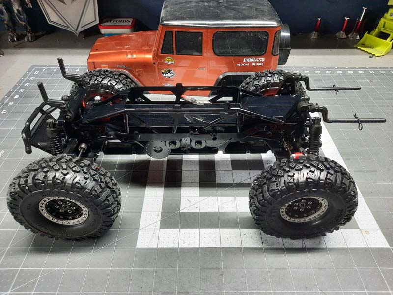

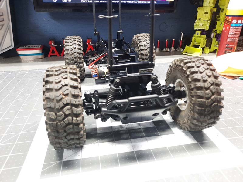

Once the chassis was together, the rest was simple TL01 stuff and I put it together in a few minutes. I really like the bumpers, pretty sure one of those is going to end up on my Dynahead. The Comical series arms is nice, they add a little bit of width and a few extra shock mount holes. I tossed the stock friction shock garbage and installed some 70mm MST shocks from my CMX kit. Springs are a bit light, but they fit great. I threw on some 1.9 tires just to see how the stance was.

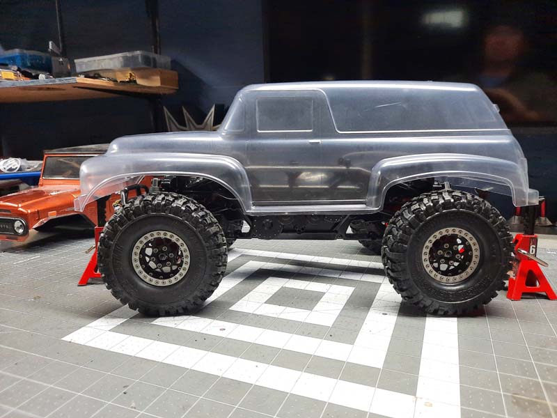

..and cut out the body and dropped it on there. Cool, but man, that chassis hangs down there. I figured it would but it seems really low. The shocks are way drooped though, I need to find some heavier springs.

Plenty of suspension from the MST shocks, and far more than I was getting from my TL01.

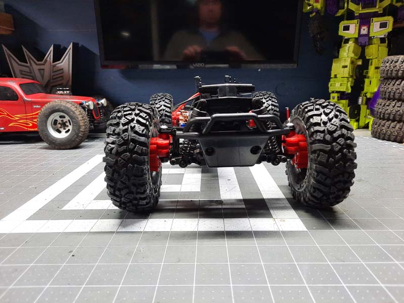

I'd really like to get another set of portals ilo pillaging previous builds, but there is nothing in stock here other than the housings. Kind of a shame, and still think Tamiya should have put them out separate as an option part since there's so many kits that they can mount up to.
So I'll steal them from the TL01 for a bit - I think they'll make quite a difference in the stance and be better used here. I do need a few odds and ends like servos, but my budget needs to recover first...
