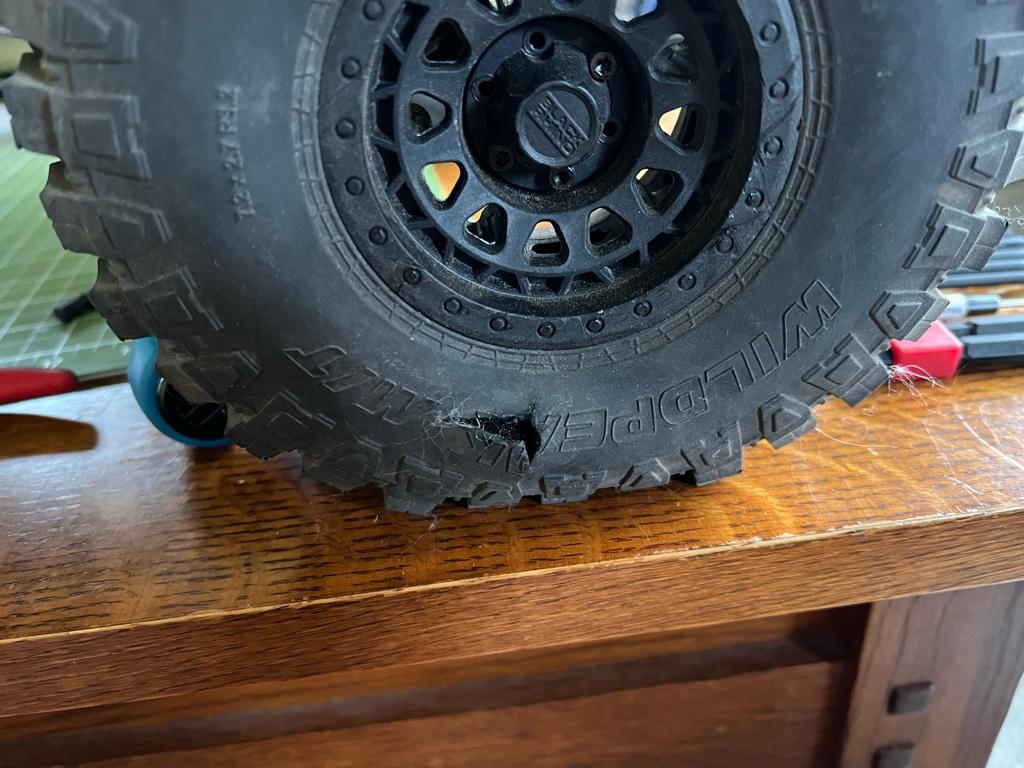

Soft foams and tires didn't bother me too much, but yea, not ideal. Too soft.
