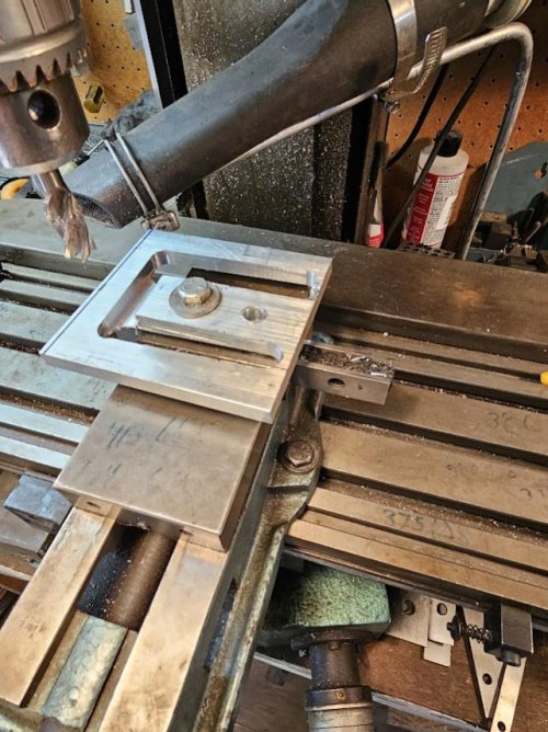

It was a pain but machined out ,gonna install it on a plate that will extend to rear of chassis

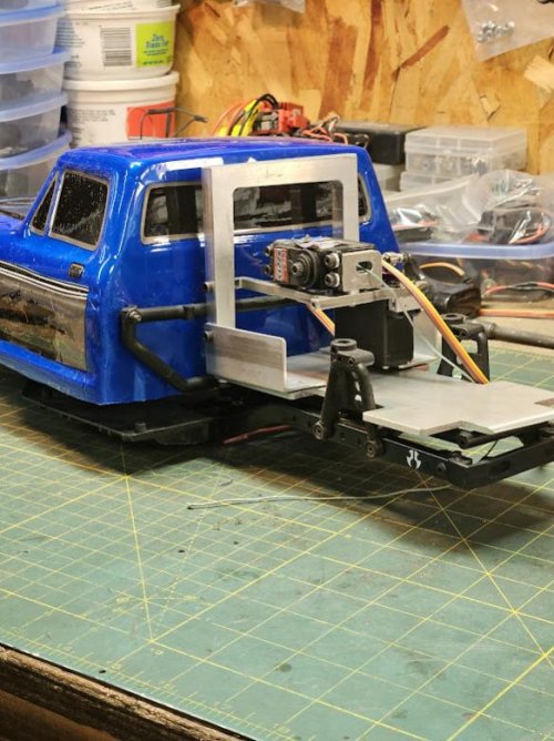

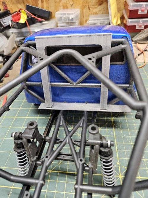

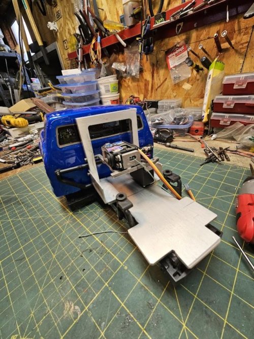

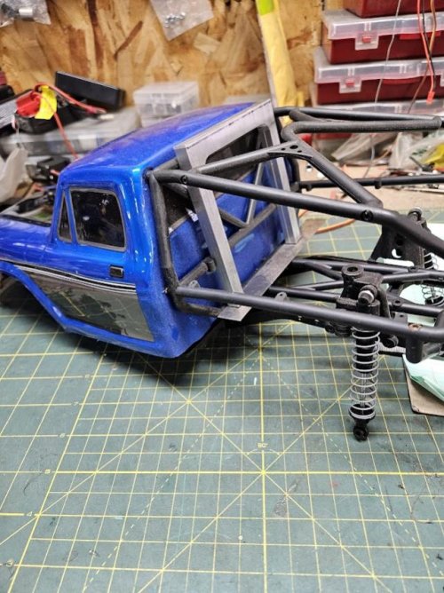

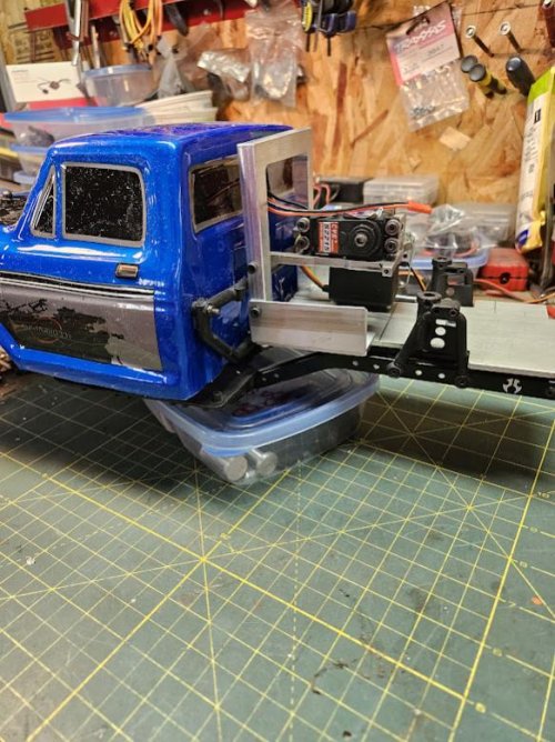

Got more work done on scale Wrecker with a Free spool remote KMS servo winch design. Am mocking it up to fit a SCX1Oii chassis ."thumbsup"

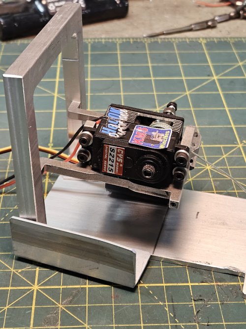

The free spool servo winch being used was a challenge. to me to be made by a friend River Hand on my FB pg. It is a k3 free spool with remote free spool function using a Heyok wireless Remote .

Made boom height adjustable."thumbsup"

Looking good! Is the freespool AND the winch operation done with the wireless remote vs your truck remote or are they separate functions?
Heyok uses a key fob to control both winch a free spool remote "thumbsup"
