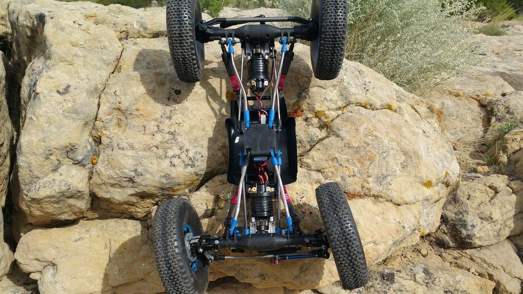

I am running a 16t 5mm pinion on the axles, 12t pinion on the motors. The wheel speed is actually quite surprising. Not sure of torque yet. Going for the maiden run on the rocks tomorrow. I'll for sure get some pics.. Maybe some video"thumbsup"
Got out for a good day of practice!
Few posers
The 400 pullers were a perfect fit"thumbsup"
So here is what I found from running this rig..
1. This is NOT a pro rig! For my courses all I did was narrow up the pro gates we were running.. And changed a few of the tall ledges, due to the shorter wheel base of this rig.
2. I need to adjust my expectations BIG time! The problem was I was going out, expecting this rig to do (not exactly, but close) what my pro rig could do. The much narrower trackwidth totally changes the game. As well as the shorter wheelbase.
After the first pack I was honestly disappointed. But after some thinking, We will be running these on the same courses as the Mini Crawlers. A mini course is NOTHING like a pro course.. the breakovers, sidehills, verticals, downhills.. everything is different! I have never setup or ran official mini courses. So I couldn't set up anything that resembled one.
In the video, you can see on gate 3, I really struggle with that vertical.. That vertical wouldn't exist on a mini course. So what I am thinking is once this rig is on the correct course, it should do a lot better?
3. These RC4WD Bully tires are NOT impressive. They will be getting changed out very shortly. But, they did show me what I wanted to know. As far as the width goes, they are perfect. But, height could honestly be shorter. Going back to running these rigs on mini courses, Having a shorter tire on this rig, would definitely help with the COG. This rig has good COG, but being so narrow effects it tremendously. The height is not needed for a mini course either. The tallest mini tire is 4.75", then you have as skid with a transmission on it. This is a pro chassis, so with short tires, you will still have all the skid clearance you need.These are right about 5.5", I am thinking somewhere around 5" would be perfect.

Looking great! The short look I got with the video looked like you might want to bump up the shock oil a bit to help with stability. Just a thought.
Good to see some more videos of this new class, especially one running a SuDu chassis "thumbsup"
It will be interesting to see how this one compares to the mini crawler.
The mini crawlers even has a tire maximum of 4.25"
The rig actually felt a bit stiff. These big bores definately feel different than the scx shocks I am used to.
That is correct! I had class 2 scalers on the mind I guess. I think some shorter tires are in order for this rig, then I think I can do some real testing."thumbsup"
I have the same issues as Hitt, I have not driven the car enough to see where the instability comes from but this seems like a good idea. Might even have to try my sway bar as it really helped my super.
