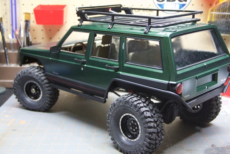

SCX10II is a 12.3" wheelbase truck out of the box. To get anything other than the XJ to fit, you'll need to change the rear link lengths. That Wrangler is pretty short and I'd worry about driveline angles. Why not go with a New Bright JKU? It's pretty much spot on without much link work. And comes with an interior as well. If you're set on a Toyota, get the 80 series that's available on eBay. They look awesome on an SCX10 and need zero link adjustment.

An XJ I did:

Blazer should work fine, just do the math on the rear link length. Do not change the front links, everything will go out of whack. XJ's a simple plop-on.
