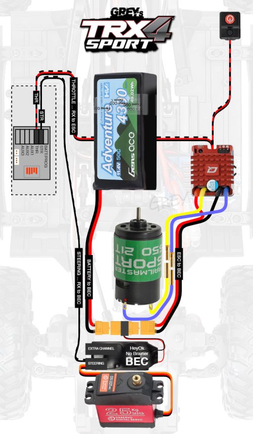

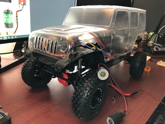

Attached some images of the body roughly sitting on the chassis. I also made myself a component/wiring diagram - see attachments - to keep it all straight in my head and to share with other newbies.

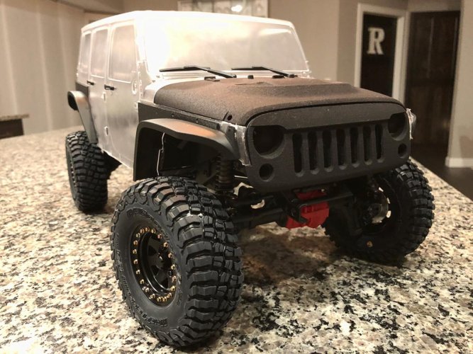

I finished the wiring (although I need to do some wire management) and started cutting the inner fenders with my dremel. I used a plastic cutting disc and it cut through the fenders easily. I used a sanding drum on the edges to smooth them out and am pleased with results. I bolted them back on and I am pretty close. I need to cut a bit more off the front of the inner fenders and then will need to make additional cuts to mount the light buckets. I also need to cut the frame tomorrow.
Parts have also arrived from shapeways and carpetfuzz17 sold me his unused KC smittybilt front armor so I have plenty to keep me busy now!
11/1/2020 Update:
- Removed hood and grill; replaced with Knights Customs parts
- Additional cutting of the inner fenders; needs to be cleaned up but...
- ...the Axial 17 Jeep JK body now fits on my TRX4 Sport!
- More to come
