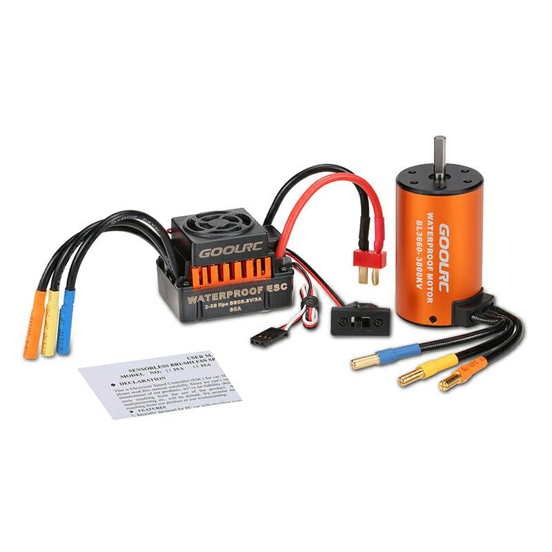

Does anyone heard about this! Does the specs says it is a good to buy or not?

Nope. He asked if the specs say if it's good. I say no. Weak BEC, weak ESC, looks like it's not sensored and he didn't say what it was for.
I know it might not always be true but in my experience you get what you pay for, especially with electronics.
The specs on that motor look the same as the Hobbywing I've got in one of my trucks. It has plenty of power, and I have no complaints in its intended go-fast application, but it would be far from ideal in a crawler.
That ESC is too small for that motor in my opinion. You've got a motor that can pull nearly 100amps constant paired with a 60a esc... the "burst rating" of 320a is probably good for 3-4 seconds before it overheats, do you want to baby the throttle all the time, or do you think it will never be under load for more than a couple seconds? Couple that motor with a 120a esc and I think you'd be fine. If it's going in a crawler, I'd either go with a lower kv, or go sensored.

Thank you for feedback. Appreciate it
I personnaly do not know about electronics so i've ask query. So, people like you who are knowlegable can help.
I am planning on installing it on my RR10 Bomber. I am kind of tight with budget.
Thank you for the feedback. Appreciate it.
I like crawling and a little bit of bashing so to speaks. Zero knowledge with electronics.
