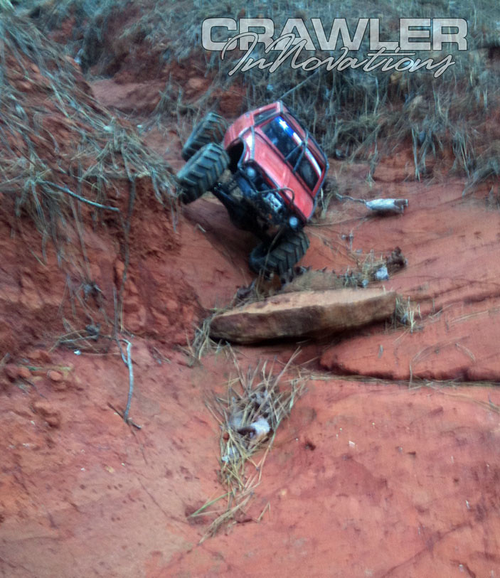

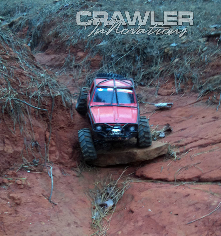

This was the first time we took it out to run it. It's a place called Eagle's Nest about a mile from house. I love this place. You have to hike in and out. It's a great way to have about 3 hours of fun if you follow the entire trail and take your time.
OK, those pictures were taken in December of 2010 on my cell phone. I had never planned to do a build thread or anything like that. The idea was to have a simple scale truck that was decent to play with. But just like every crawler, I can't leave anything alone. This truck quickly became a test mule for new parts.

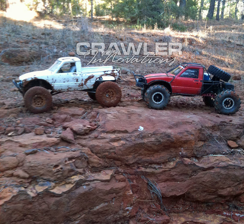

Not much was done to the truck from March through mid May. On May 14th, 2011 ETXRCC & Crawler Innovations held our season ending BBQ, 2.2 & 1.9 comp and we held our first G6 event at the C.I. compound. This truck performed very well. Here are a few pics from that day:

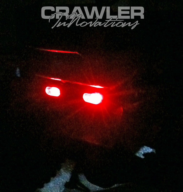

After the G6 event I was so excited to do anything with scale rigs:ror:. All I wanted to do was to make each one of my scalers better. The problem I have is time. I don't have hardly any time to do things for myself anymore. I am a big Toyota fan. I use to own an '81 4x4 yota. So I seem to always collect cool Toyota scalers. So consequently, I stock pile parts for them here and there. I had a clear windshield, interior and lights sitting around and I wanted to really begin scaling this rig out.

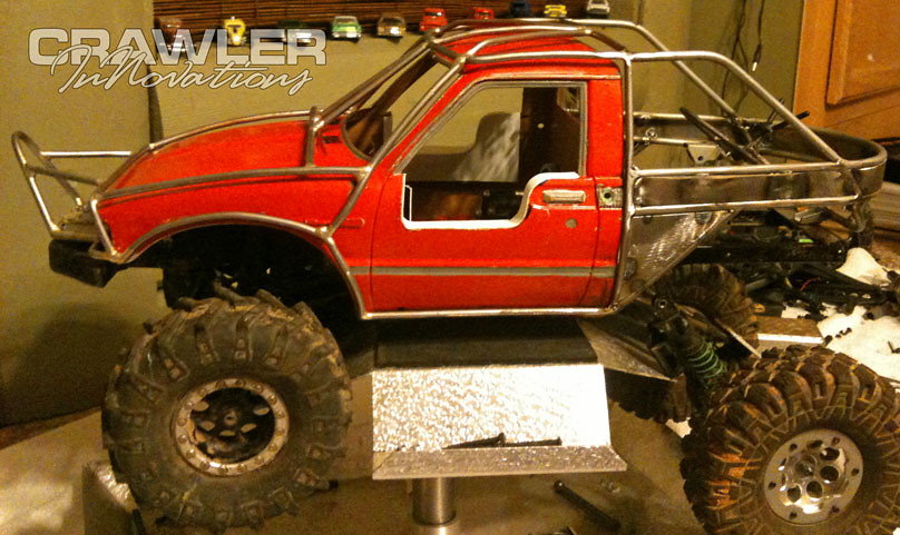

My kids finished the school year just before Memorial Day weekend. Unfortunately, Gavin got sick for a week. So while he was down and out of the shop area, I got to work on his truggy. I started by fixing the back of the cab with new styrene because Szcerba had cut it out to clear the dig he had in it at one point. I then added a Bruiser interior I had removed out of another Toyota I own that is being built into a TTC truck now. I added the clear windshield, re-mounted all the electronics to clear the interior and then kinda got stalled. I wanted to do the lights, but I was having issues with the cab not wanting to stay centered in the exo cage. About this time my good friend and machinist, Clay, of Carter Fab & Machine came over and we got to talking...

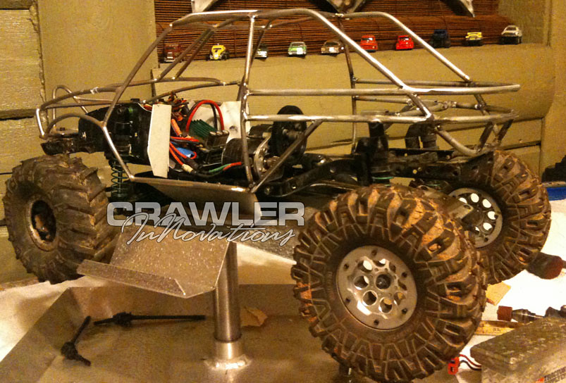

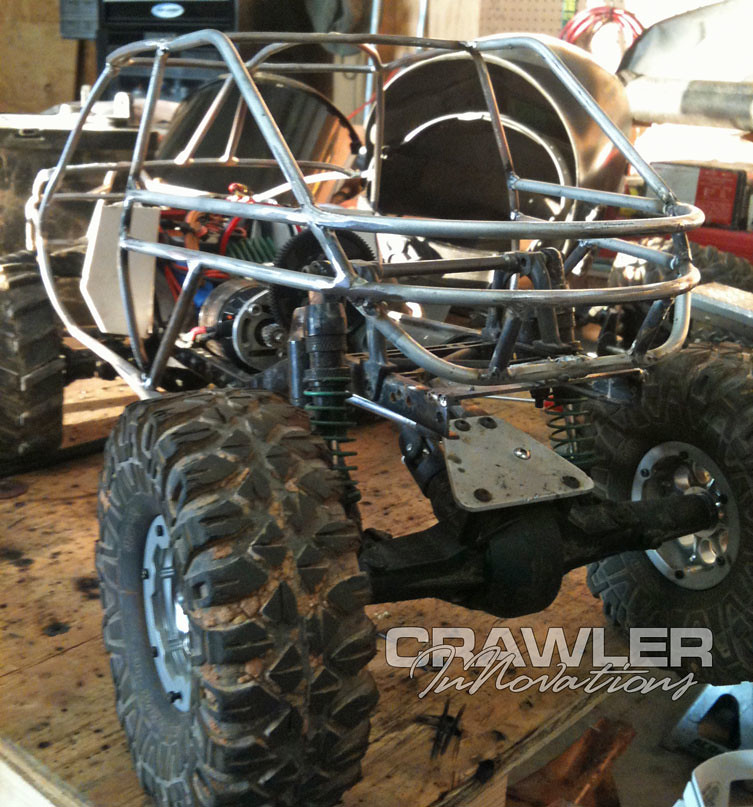

Again, these are not the greatest pictures, but this truck was never intended to be used for a build thread:ror:. So now Clay has the truck. All he was suppose to do was weld in a tab on each side to center the body inside the exo-cage and well...
...these pictures start appearing on my iphone:twisted:.
By the way, these are the reduced 2.2 to 1.9 RC4WD Spooky Crawler Tires I made for Clay with C.I. foams of course.

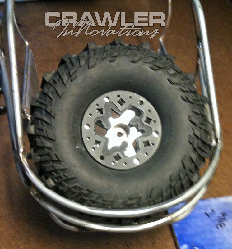

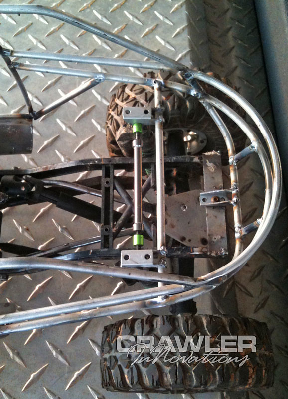

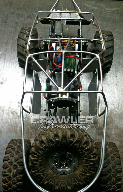

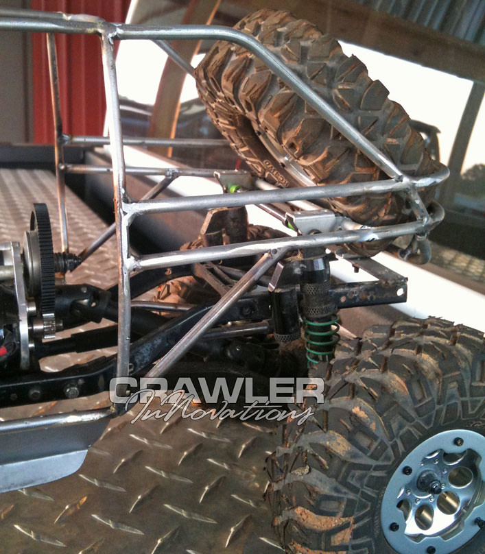

The boat sides had to go in order to get the cab out to weld the new rear cage on. The cage had some issues, but rather than start over we decided to roll with things as they were. It was Clay's idea to make sure everything fit the nearly 5 inch tall reduced Spooky tires in the back. That way the new rear cage could handle a tire that tall since the SORCCA rules allow 4.75" Tall in class 2. I am waiting for the new 1.9 Pit Bulls for this build. I think this truck performs best with 4.50" tall tires on it.
No more plastic shock hoops in the rear"thumbsup"
I just had to throw this in here; These are the Naked Lady Bead Lock Rings made by MTHead here on RCC. They are Clay's favorite bead lock ring ever:ror:

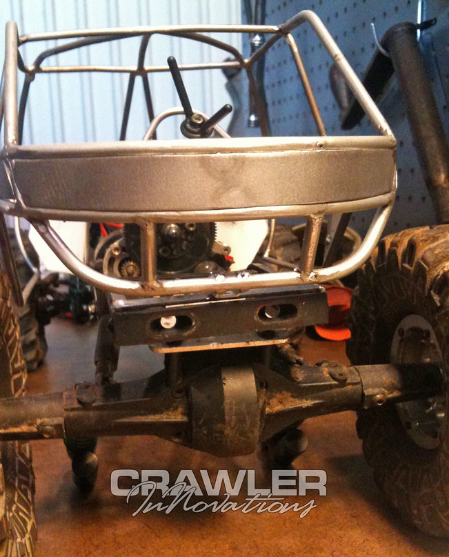

More progress on the rear cage:

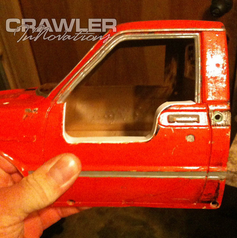

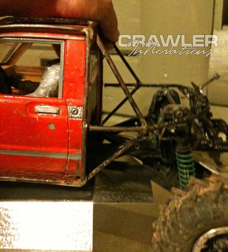

So with all this rear cage work going on, the boat sides removed (which use to hold in the cab in the cage), and we still don't have a way to center the cab in the cage:ror:. The question from me to Clay is, "how we gonna hold the cab?" My suggestion to him was, "why don't you just run a bar across the doors and call it good?" Not for Clay. Here was his picture reply:shock::

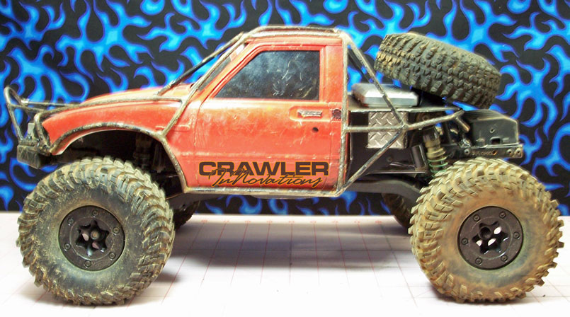

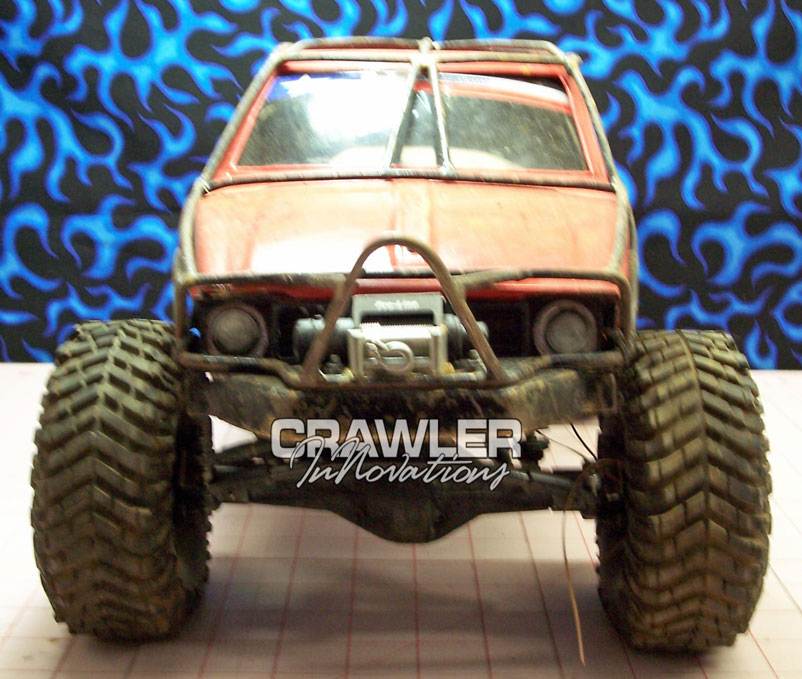

As usual for me, I am late to finishing up the build thread:oops:. I definitely owe an apology to Carter Fab & Machine for taking so long to finish this up. Sorry about that Clay"thumbsup".
Here we go:

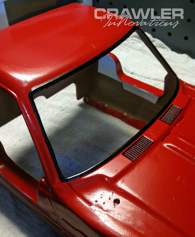

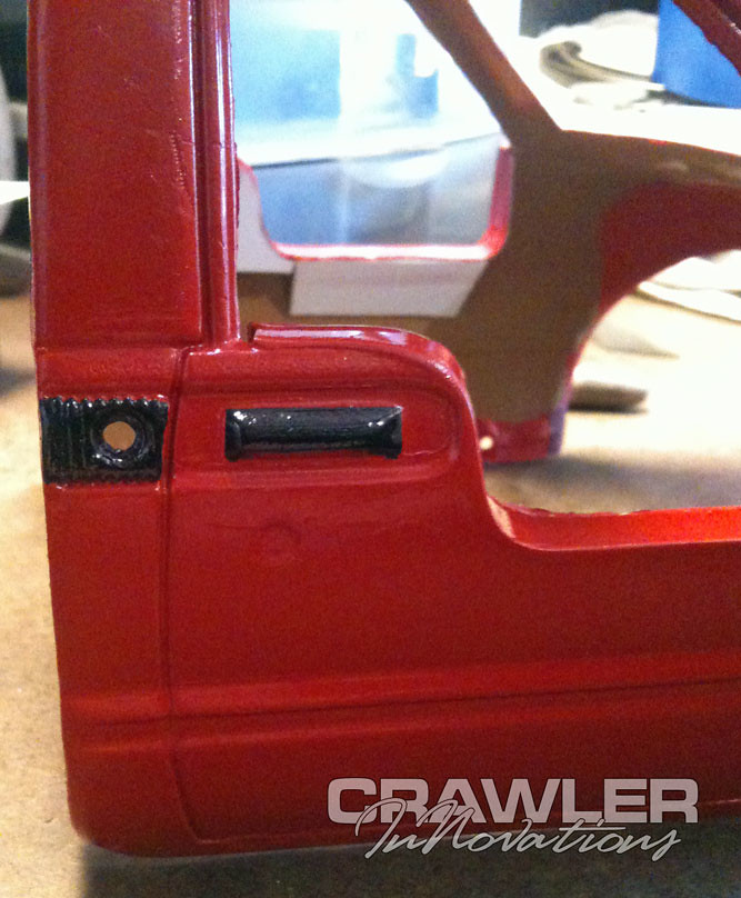

Fresh Red Paint Job:
Some of the Carter Fab & Machine attention to detail:
