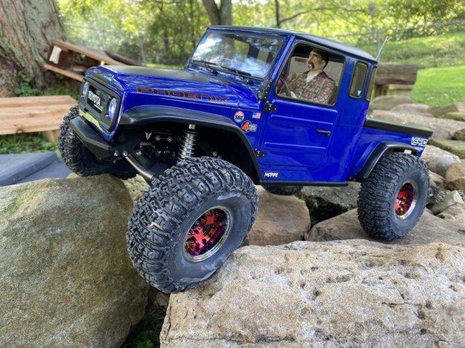

I kept forgetting to look at the new body you painted... Holy smokes. Oh yeah.. looks like a nice job on the body too lol. Came out really well.
Cutting the mask on the outside was quick and easy. Definitely the way to go.
Looks pretty awesome detailed out. Needs a bumper pretty bad though.
Resembles the 1/1 with full doors.
