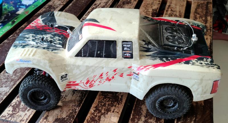

I feel like I got super lucky! DRED805 sent me his old Yeti Jr. Trophy Truck, filled with Axial aluminum mods. I swapped the trophy wheels/tires and body onto my old Yeti Jr. chassis. My 3 year old sons LOVE it, and one of them usually sleeps with it. I've let them drive it, on the 50% throttle setting and they're starting to figure it out. They don't really care if they haven't figured it out yet though, they just love doing anything with it.
The chassis DRED sent me which has all of the upgrades sits like this currently:
Empty. Having so much aluminum goodness in this thing, I wanted an electronic system that could do it justice. I bought a Castle Mamba Micro ESC and a Castle 5300kv sensorless motor to give this thing the power the aluminum upgrades were built to withstand.

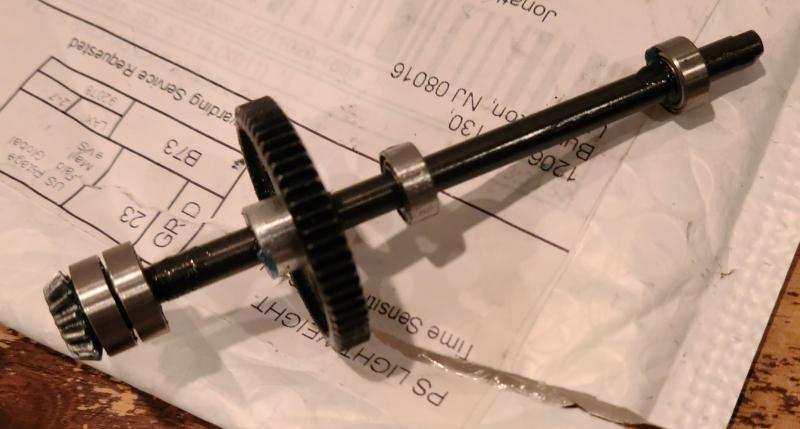

Unfortunately, Castle electronics are great at finding weak spots, and they didn't let me down. The center driveshaft that sends power to both the front and rear wheels is plastic from the factory. The Castle system made short work of that.
Also unfortunately, the only company who makes an upgrade for that is GPM. I don't like GPM because **** China. Nonetheless, I've got one on the way, but it'll take a month to get here.

Well finally, the center driveshaft came and got all built up. This thing sits in the bottom, center of the chassis and the car is basically built around it.

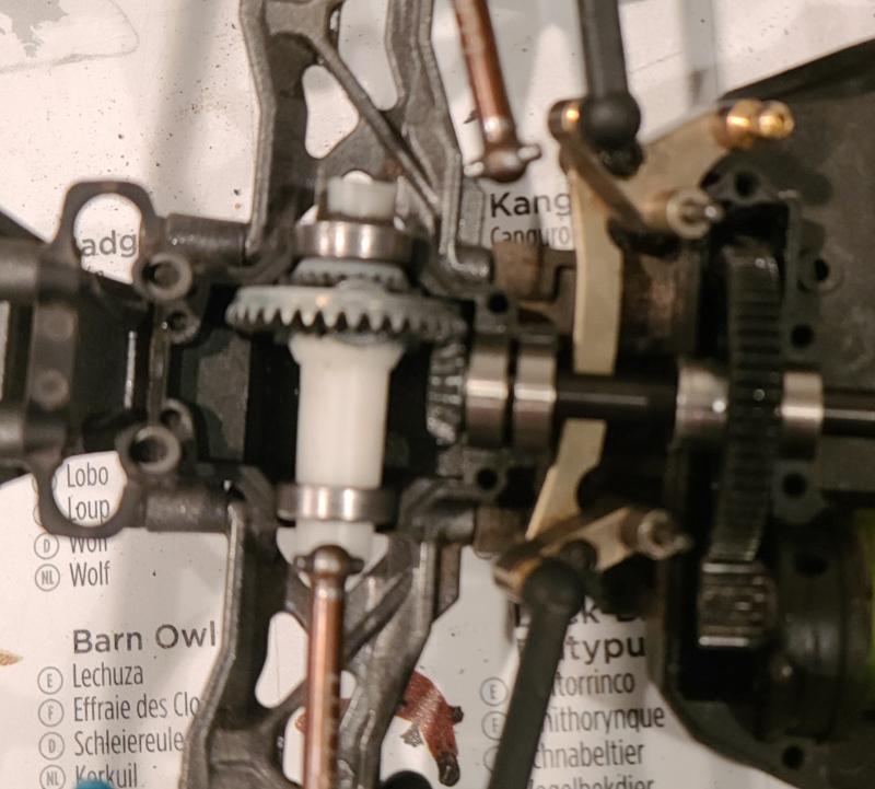

I mentioned earlier how Castle electronics really don't like plastic drivetrain parts, and will basically seek and destroy them. This chassis came to me with both differentials locked. I planned to drive it as a go-semi-fast rig, so I opened the front using the stock differential which is plastic. The 5300kv motor turned my Yeti Jr. into a 2wd truck, as it shredded the gears on the long output side of the diff.
It took me several tear downs to find it, as the teeth looked fine, and the differential performed normally, until both front wheels were making contact and needing to lift the truck. Then it was like the front wheels had a loose slipper clutch and wouldn't spin. Since an all metal drive train is required, back to the locker in the front I went.
