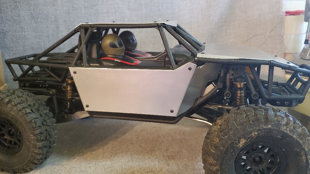

my newly built Gatekeeper. running the HW Fusion 1800kv brushless, the IFS Kit with the Knights Custom IFS skid plate that raises the diff along with SSD Brass knuckles up front and rear pads.
I 3d printed a toolbox out back to fill in the empty space and came up with an oldschool looking paint scheme.
Went with 30wt oil in the front shocks and 50wt out back, used the 2.09lb/in out back and the 2.47lb/in in front, i'll see how it does on the trail.
When my SSD Diamond AR44 arrives i'll swap out the SCX10II axle out back, kept the stock ones for a future build.
Gatekeeper panels are almost ready, just need a bit more fine tuning. Should be listed in the vendor section in the next few days...
