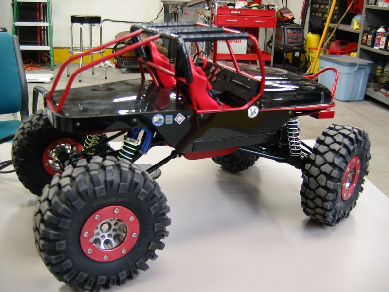

It looks like I'll have to re-upload the pics to PB; they got deleted somehow. I'll have to wait till I get home to do that.
EDIT: Here ya go.

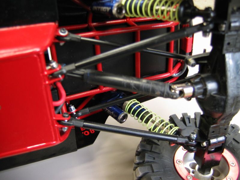

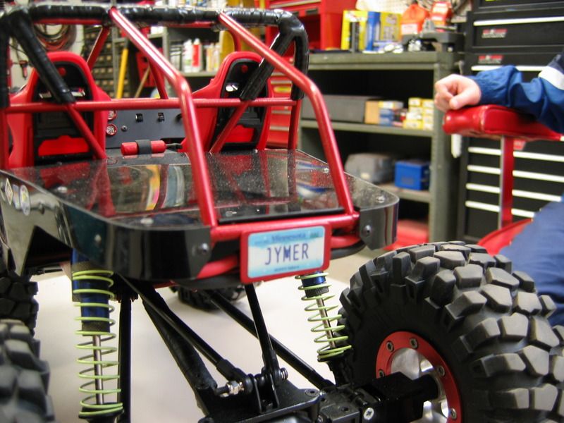

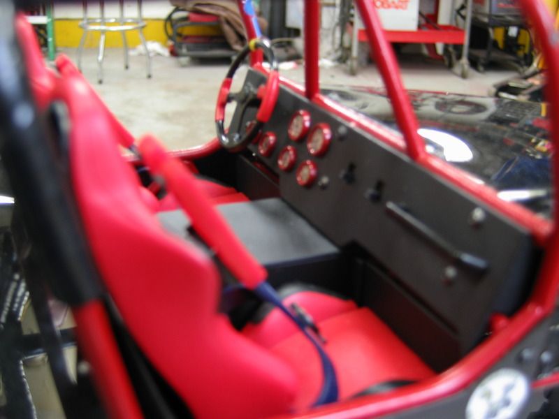

The left switch on the dash turns on the receiver, and the switch on the right turns on the lights. The pics were taken the night before I finished up the rock lights.
The battery connector secures behind the license plate.
The only modifications to it since these pics were the addition of the rock lights, and the tires got swapped out for 2.2 Swamp Dawgs. Those smaller/wider tires really made an improvement on how it handled.
Thanks, I just wish I would have taken pics as I was building it. The braze joints turned out really well.
I guess I'll have to take some the next time I fully disassemble it.
