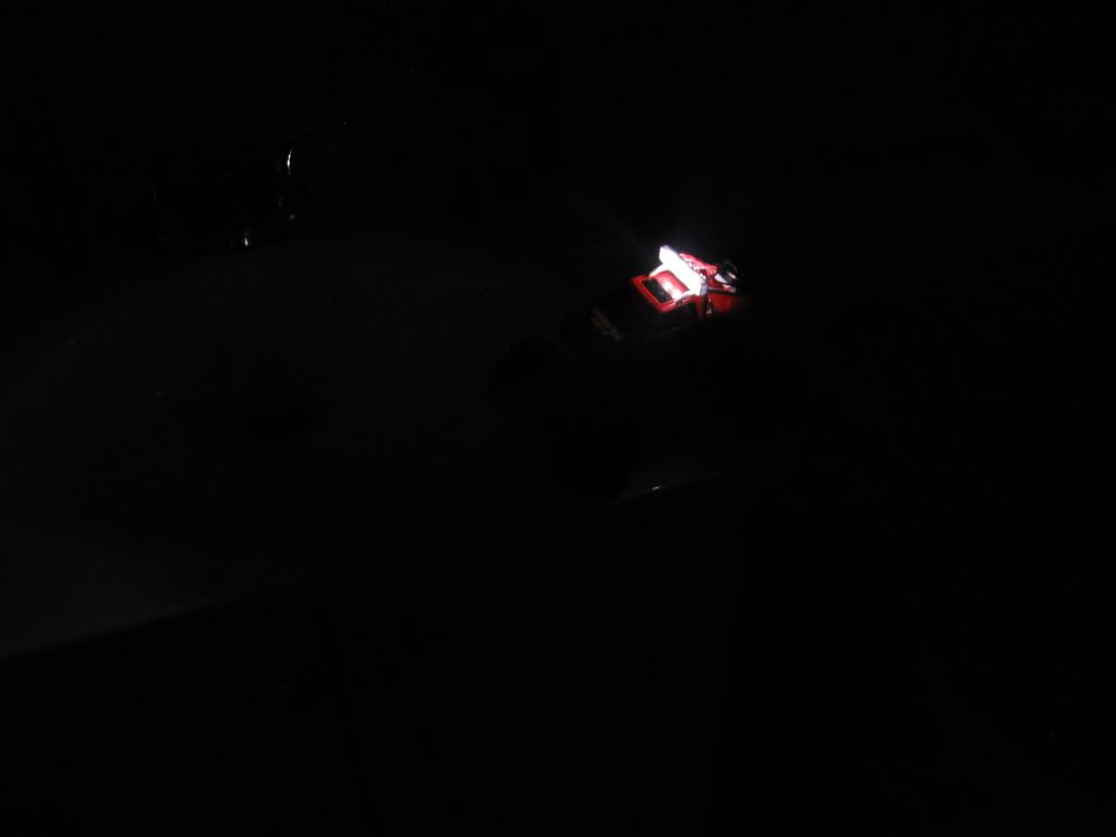

Be sure you have a good soldering iron with a fresh tip. The joints on either end are a pain in the nuts to do. Because of how they are wired, you will have to cover these joints in liquid tape to weatherproof them. Shrink tube works well everywhere else. If you wired everything right, your lights should work just like mine did. Since I finished this in the morning, I took some dark shots in the bathroom to see how bright they were:
The camera doesn't pick it up, but these are actually bright enough to see the whole room with. Not clear as day, but pretty impressive for about $15 in parts, and definitely enough to light up a trail at night. I'm going to wheel the truck tonight and see how they work.
