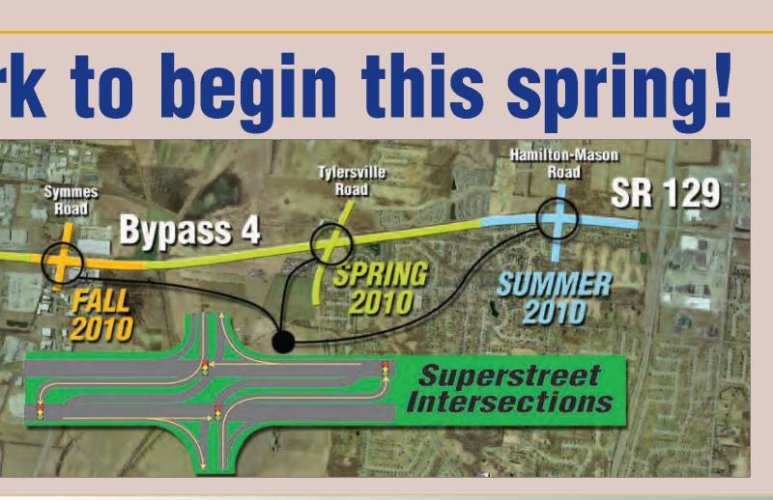

That looks alot better than what they are planning to do here this summer. They will finally be widening out a bypass road and turning stuff over to some "Superstreet"...It looks like a clusterfawk :roll:
Here's a video i found of what it is going to look like
http://www.bctid.org/BCTID/Downloads/Videos/superstreet2.avi
Heres a pic of a recent article showing it also..
