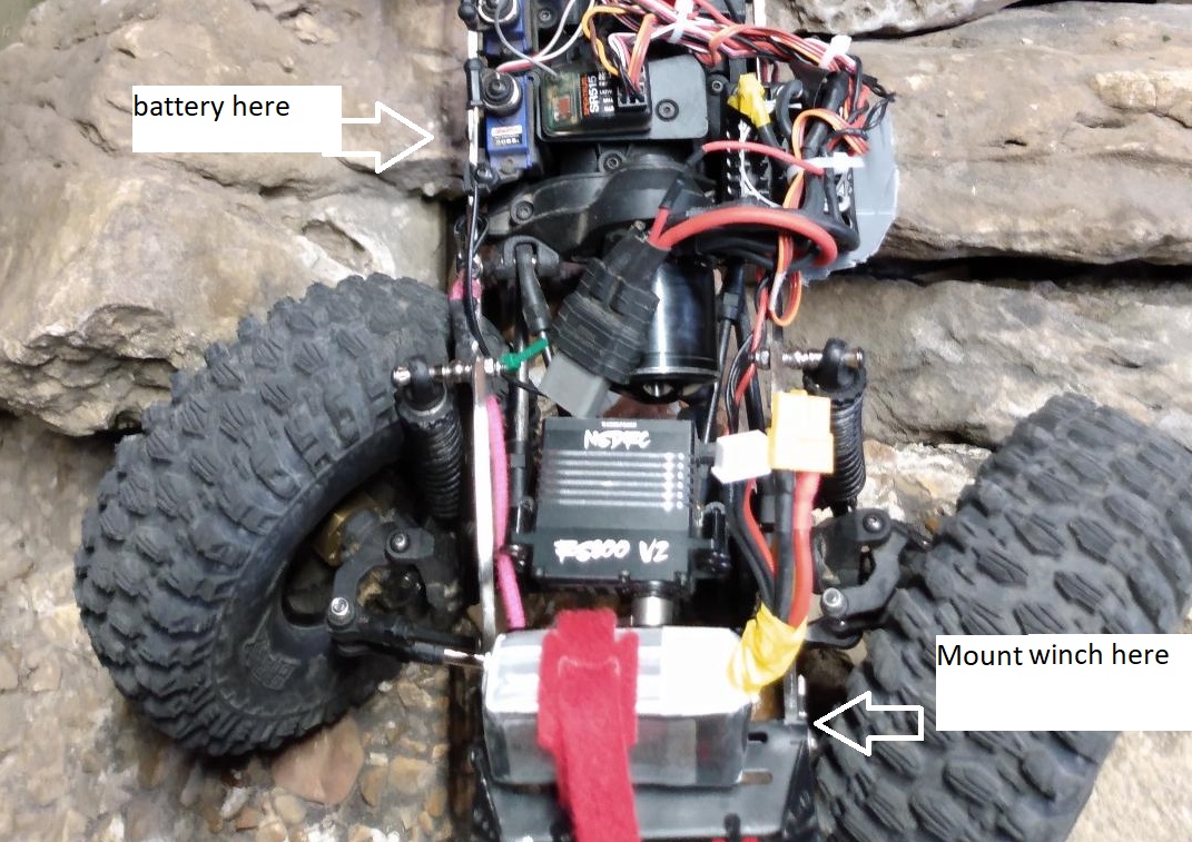

Right now I am running and SW4 which has a crappy internal BEC but I am thinking about going to a MambaX. The mini's size and mounting on its side is the important part and I don't want to have another component for the controller. Space is an issue.
I used that one as example because of the avaialbe mount. I want it to lay it on the winch mount on my bumper. I am able to set the mount part of my bumper back under the body back far enough so it doesn't stick out past my front tires.
I want to sit it back where the battery is now on the pic below and the battery will mount opposite side of my ESC.

At this time just 3s but I have a MambaX sitting on the bench ready to go in. I can set the MambaX up to more power (not as much as direct power) but I do still have an original TRX. I can replace that mini servo if necessary. I would rather change the TRX mini to one that can handle more power than get an external BEC. The body I have fits tight and with the front SOA set up space is tight up front. There is already more than enough wires in my rig, I don't want more.
