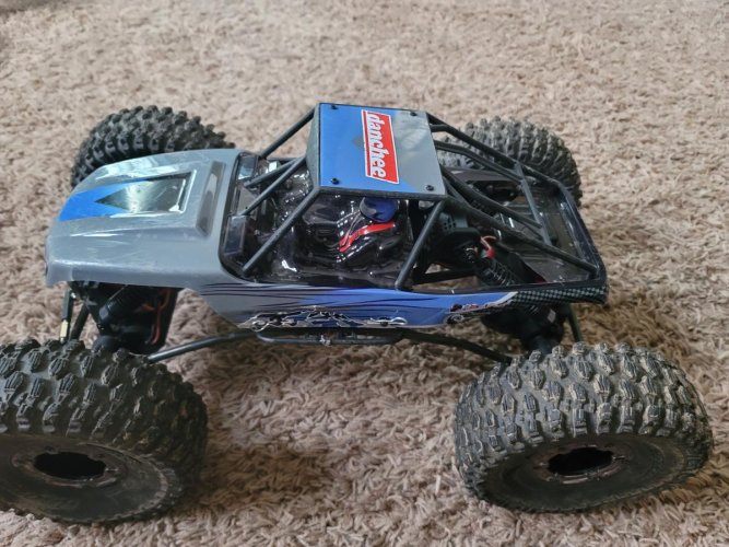

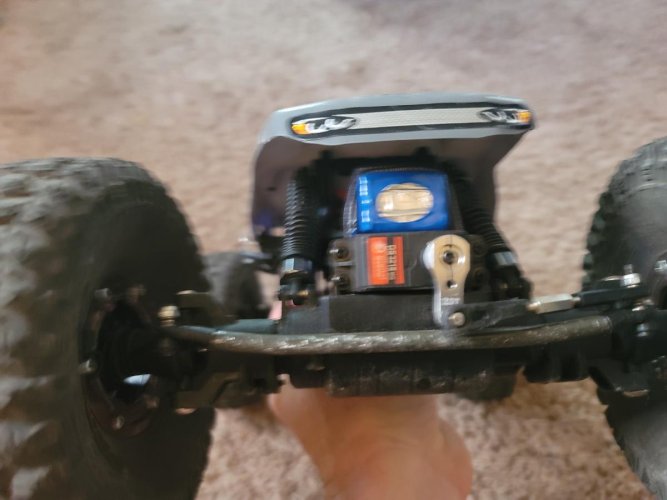

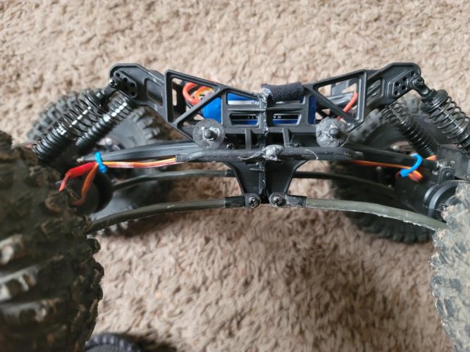

Chassis Chop pics what do you guys think, also I did pull some of the bend out of my lower links to minimize the axles from hanging up.

I like the chassis mod, for some reason I was thinking you narrowed it rather than shortening the wheelbase.

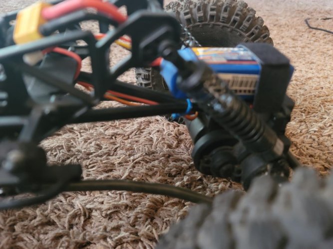

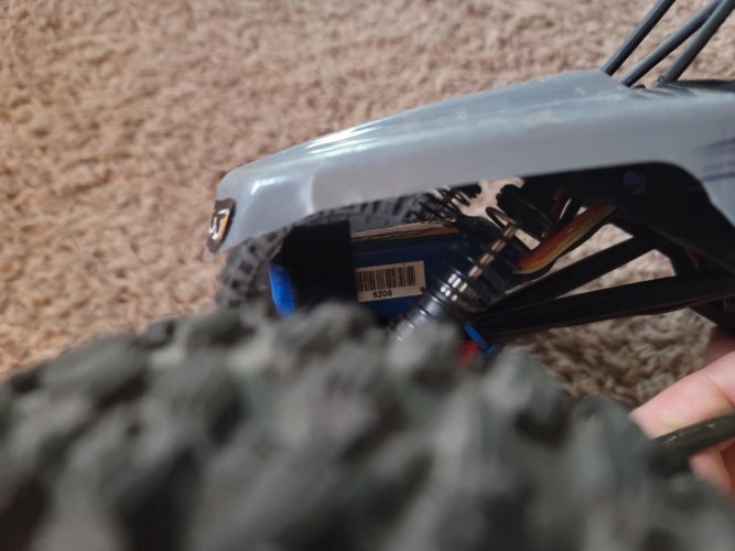

Modded my Battery mounting position again, took the front servo out to put the battery strap under it. Then I just mount the battery on top of the front servo, giving me front un sprung CG, and the best part is I dont have to remove the body to swap packs. "thumbsup"
