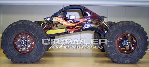

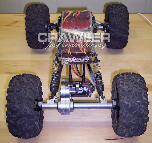

Here are some picture of my Rock Beasts mounted up on my son's berg. This was one of three different bergs these tires were tested on. In all tests, we switched the complete wheels from crawler to crawler.
Here you can see how wide the tires are and the track width they give:
Side view:
5.25 tall in the rear mounted on the crawler.
5.125 in the front mounted on the crawler.
Even with the VP DH 585 front hubs, they get into the springs and links.

Now that these pictures have been posted and the review done, the fun begins for me. Siping, grooving and narrowing of these tires is next:twisted:. More updates and pictures to come:mrgreen:.
