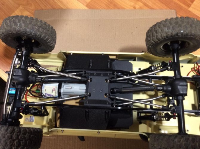

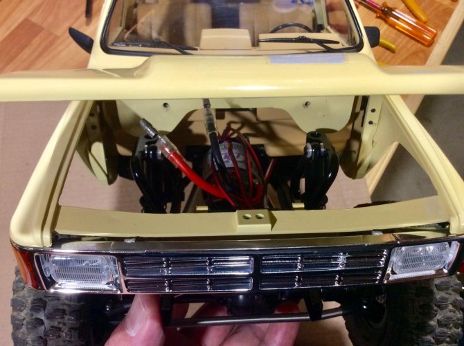

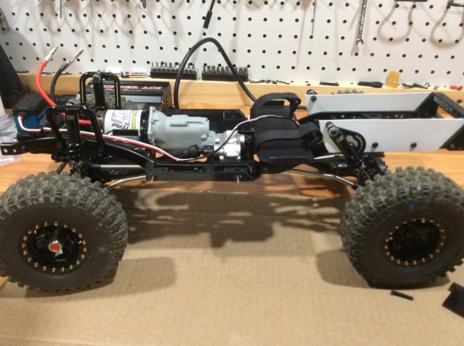

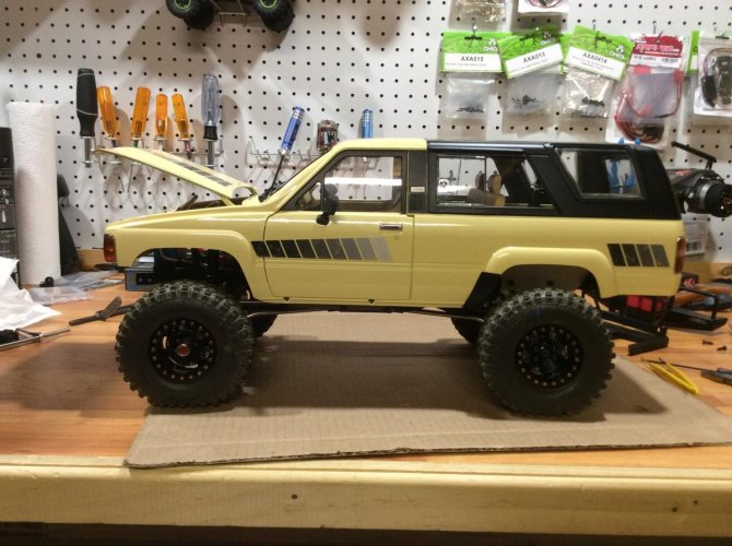

Personally, I start with the body and pick a chassis to fit. I would pick the SSD Trail King over a SCX10 builder kits. The transmission/transfer case allows for deeper interior. Plus the aluminum chubs, knuckles, shocks, To links and metal Panhard mount make it worth the extra $70.00. With the 4Runner body, everything clears without chopping up the interior.
