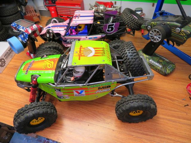

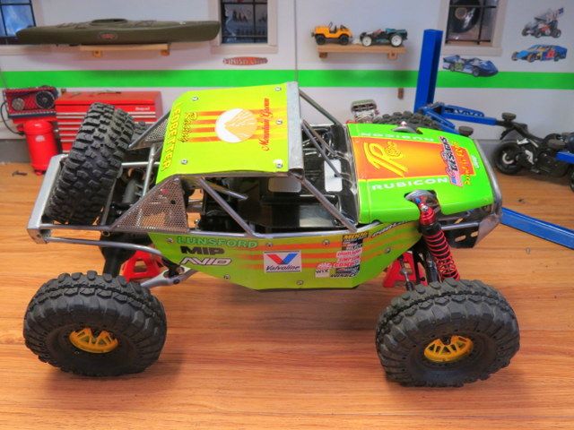

Another small update,
Added some electronics, weathered some SSD wheels, and some new tires.
I like the look the new wheels and tires add.
The body and wheels continues to rust."thumbsup" When I want it to stop I just need to shoot a little clear on it.
Still need to add the rest of the electronics and program everything. Not my favorite task, so I always procrastinate this step.:twisted:

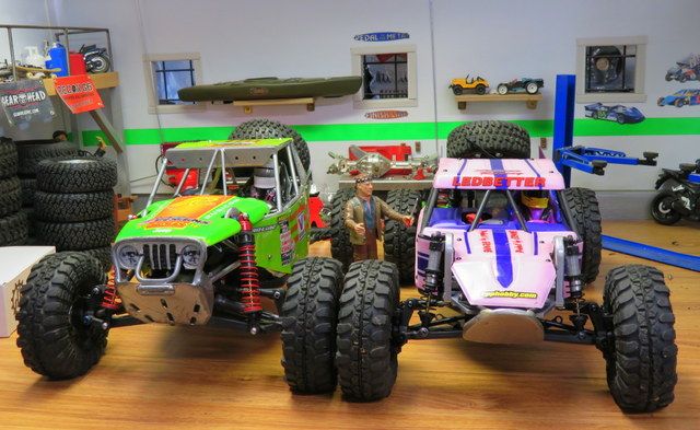

Just wanted to show the two Twin Hammers I have been working on for my son and grandkids for Christmas.
Ok, so this is where I left the build last year, so everything from here is new!
I've done a couple versions of the front travel mods and really like how this came out. Hope some of you handy guys try it!
