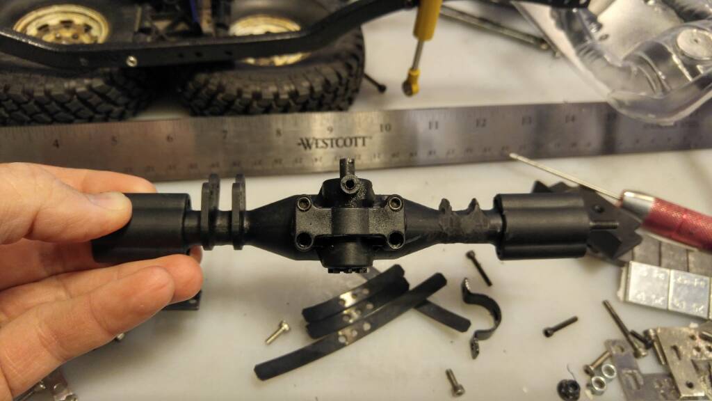

Ok... So weeks later at roller status... Other projects kept coming up. But anway alot to catch up on. I wanted great control and needed narrow axles because I did not want to cut the body. So we made a set of narrowed Losi nightcrawler axles. Paired with the nightcrawler transmission for a low profile and more room for the interior. A dremel made short work of the link brackets to allow for leafs to be ran.
