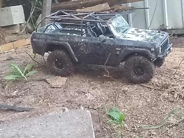

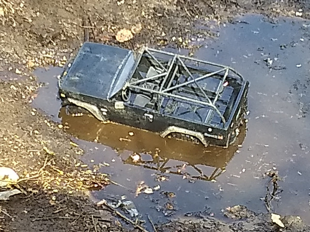

Couple pics of some mud time we got in a week or so ago in the old crawler area we setup in 2010. Cleaned it up and expanded for more play area.
