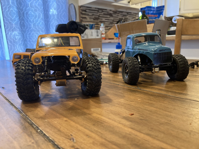

Few more updated pics. The bodies are pretty hokey looking but we are going for performance above all else. The power wagon is on a mofo chassis with torque beast and V1 esc. Has a bunch of brass mofo parts too with treal bead locks running patagonias without foams.
The jeep is a work in progress with lots of similar parts. I’ve stretched the front end out and have a warthog chassis coming in the mail. We have been waiting way to long for the Emax servos, they are some updated pics.
Anyway here is an update.
That's cool, one big tire rig and one small tire rig. Great for doing performance testing.
