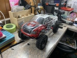

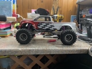

Ok, so I have dove in neck deep and the parts I had sitting around are not quite what I thought they were. Nothing quite lined up like I thought it would.
After a few iterations of links, I think I’m good where I’m at with that.
The cheap, purple shocks I got, are just that… actually, their not really that bad, just has stiff springs. I’ll drop some Traxxas yellow dots on them and see where it goes.

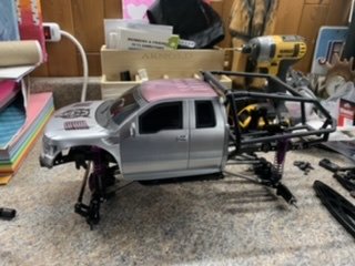

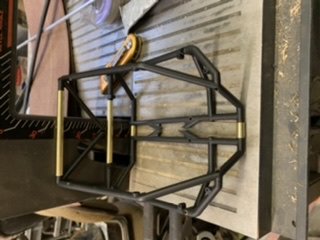

I am hacking up an old New Bright Raptor body and have narrowed a Honcho rear cage. This body will be a surprise present. Either for Christmas, or her birthday just after Christmas.
My daughter is really into wolves, her and her friends are the wolf pack…:lmao:
So, this body will be tailored to that.
I’m working on getting pics uploaded.
Looks great! I bet she will love it "thumbsup"
Thank you sir! "thumbsup"
Honestly, I am learning tons about what I don’t know…:lmao:
I really thought this thing was pretty much going to throw itself together, boy was I wrong. Literally, every twist of the hex driver and turn of the nut driver brings on a new challenge. So far, I am overcoming them, but man it can be a struggle.

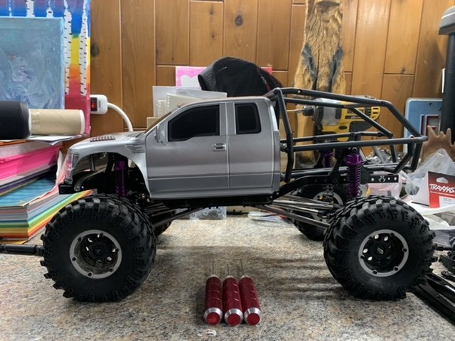

Ok, when I get home in a few days, I will be mounting the cab to the cage.
I need, or shall I say, want some opinions on how high to mount the cage to the cab.
Close to flush with the top of the cab:
Top bar a little above the cab:
I like it either way, so it’s a hard choice for me…
