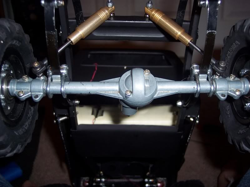

The Bruiser mountaineer does not have a differential, its just a pinion gear and ring gear. The front of the truck, in stock form, uses a one way front bearings. This means, you only have 4wd when going forward, so if you get stuck and need to reverse out, you have no 4wd. The front way hubs can be replaced with hubs from the rear, however, you must be careful now because this will put added stress on the front inner axle shaft. This is a weak point for these trucks and are found commonly broken.stock front hubs can be JB welded as well for full time 4wd. ***NOTE- the stock hubs are left and right specific! if you put them on the wrong side they wont work correctly***

Front axle "play" or slop"
Front axle play or slop often comes from worn front king pins. This can be fixed one of 2 ways. Dave Engle came up with the idea of cutting aluminum soda cans into very thin strips and using it has a shim. This works well as I have done it myself. I typically find, that the easiest way, is to take the king pin plates, bring them over to the vice and smooth the little hump in them flat. The when re-installing, install them so the hump is inward towards the ale pin.
