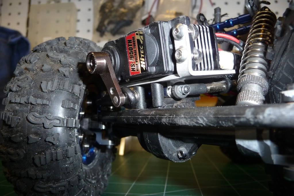

Infectious R/C Proto-type full size Servo mount:

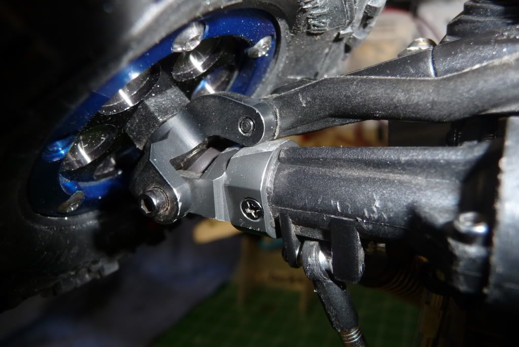

I clearanced the Cs for more steering:

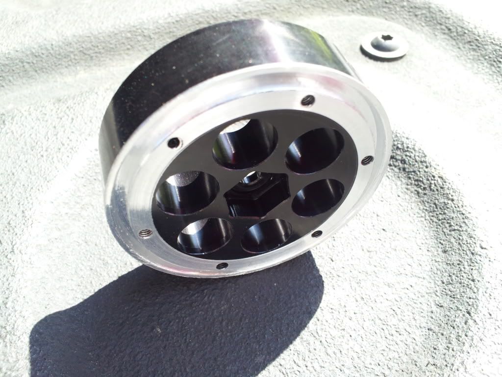

Narrowed 1.9 VP wheels:

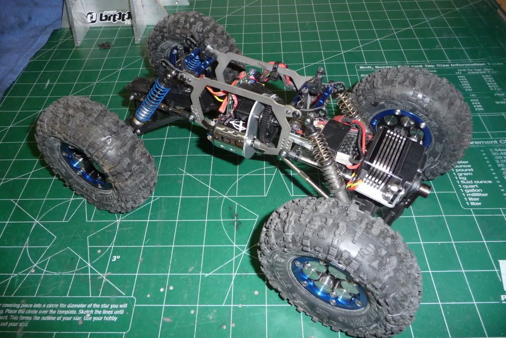

Infectious R/C's Titanium chassis was clearanced a bit for the 66T Spur gear:

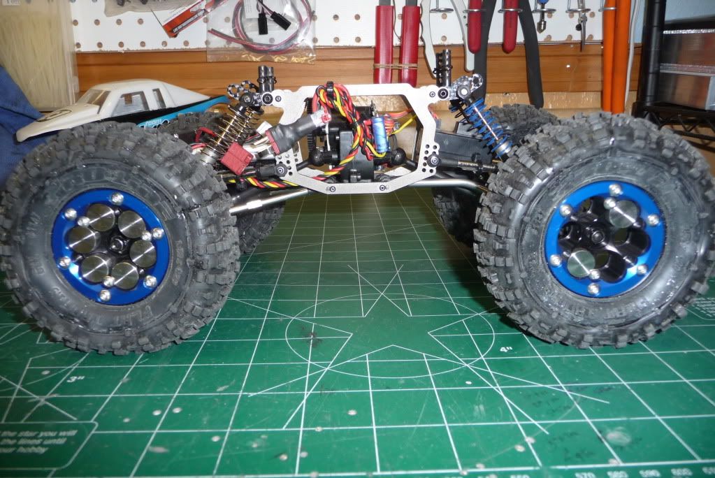

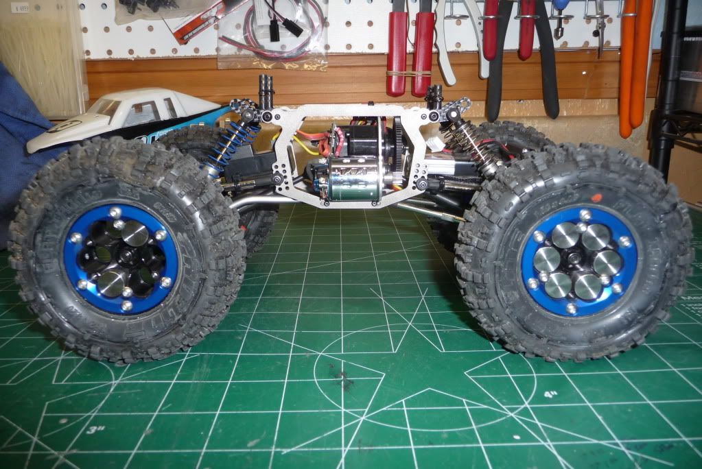

Misc other pics:

Steering: Hitec 7950 on a Infectious R/C aluminum full size servo mount, Losi Cs clearanced for more steering, Losi zero ackermann knuckles
Wheels: VP wheels, narrowed and full of slugs
