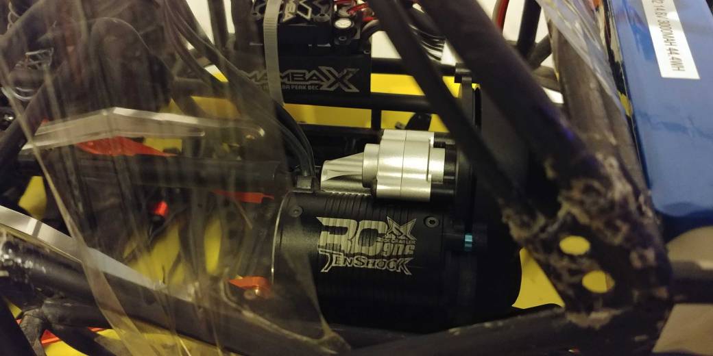

This will have to do until the sv4 is ordered I have a stock slash 4x4 32p spur gear and slipper with an 11 tooth Pinion. I'M running the ssd high ratio transmission, and on 4s this thing fly. Best part is its still really good for low speed obstacles. Won't win and crawling comps, but is maximum fun! Motor is the tenshock 6 pole 1750 kv.
Plastic is actually tape holding my cage together while the glue dries... (made a custom look)
