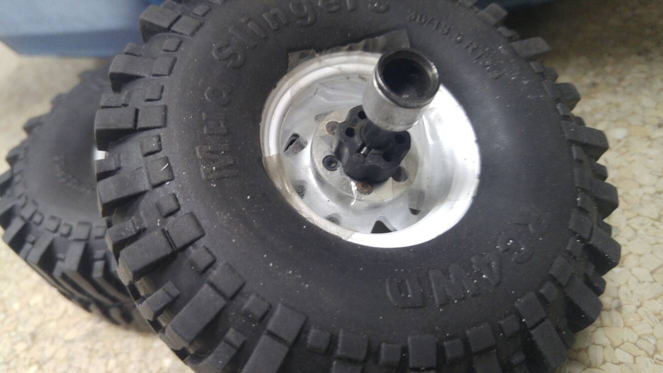

The scale hardware needs a 2mm socket. I turned down a screw and it worked like a charm.
Didn't exactly fall together, but not the worst beadlocks I've ever assembled. Used a bit of Windex to help things along, and soon I had them all mounted. I added a wrap of lead weight around each BL ring. It's old school, but there's not a lot of options for mounting weight down low on the CFX/CMX so weight in the wheels it is. Works fine for my driving style. (Beef Tubes now has weights for the MST rigs, but I didn't have $50 for them, so old school lead weights it was.)

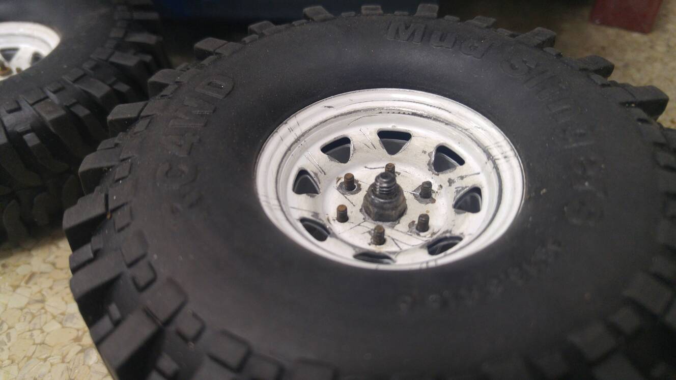

Comparison shots with my 1.55 Mudthrashers. Just a slight bit larger OD, width is about the same.

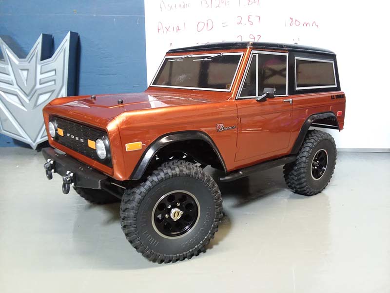

Mounted up on my CMX. I wanted to mount them on my CFX, but the wheels didn't clear the knuckle weights, even with the wider hexes. The CMX is bone stock, and they fit right on. I left the center caps off for now in case I need to made any changes. I'm not a fan of the tire's sidewall design - it's a bit too aggressive looking to me, but overall I like the look.

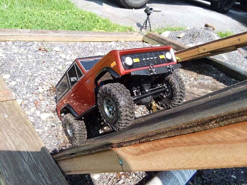

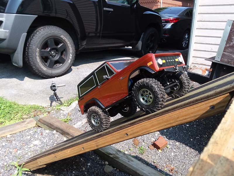

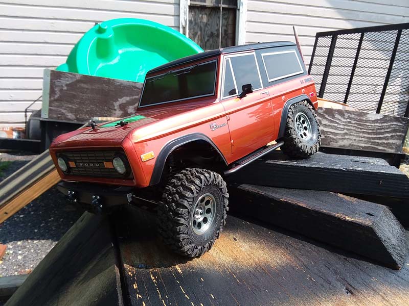

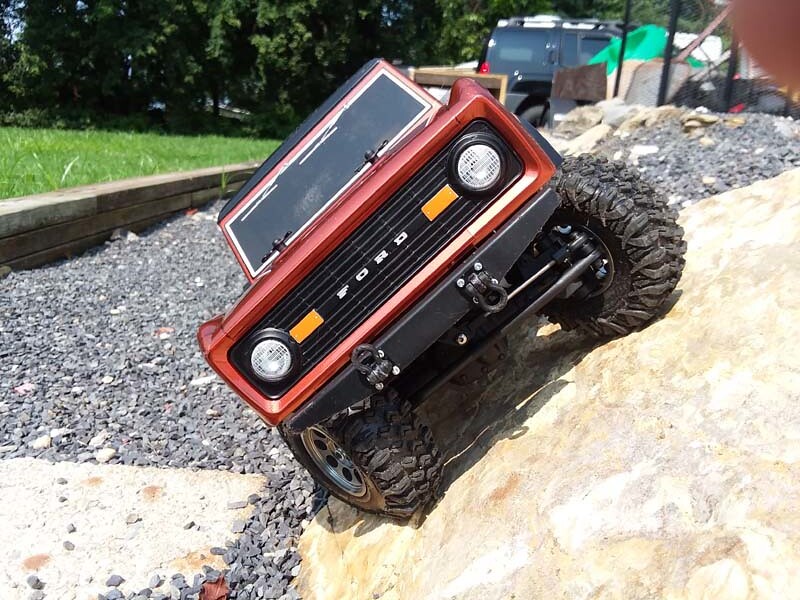

Snuck in about 30 minutes of testing. I'm sure they'll need a good trail run to fully break in, but they did great. The wide tread really digs into the loose stuff where the Mudthrashers struggled.
Sidehilling was good, though the foams were a bit soft. Not too bad though, not in any hurry to change them. The CMX is relatively light so the single stage foams worked out fine.
Great grip when climbing. I'd say they are on par with any of my big name tires.
Didn't make it up the 55d ramp though (but neither did the pitbulls) but had no issues on the other two.
The extra heigh comes in handy with those big MST pumpkins, but I did have a lot of tire rub. Think I'll move these over to the CFX as the body will accommodate them better and put the mudthrashers back on here.
All in all, pretty happy with them. Best little tire I've got so far. "thumbsup" Now down to loosen up that D-ring - that drives me crazy!!

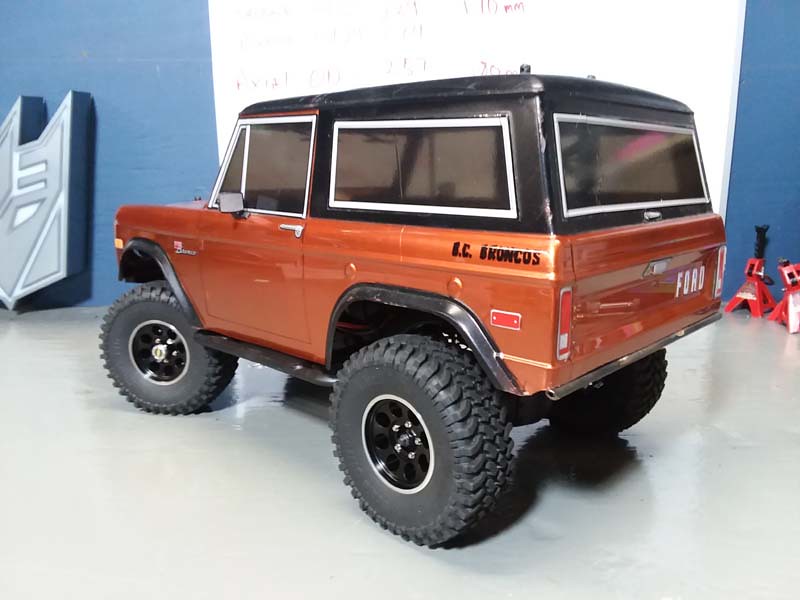

I moved the tires over to my CFX, just have to paint the body once the basement dries out. Fits the body better. The Bronco has the Mudthrashers back on it.

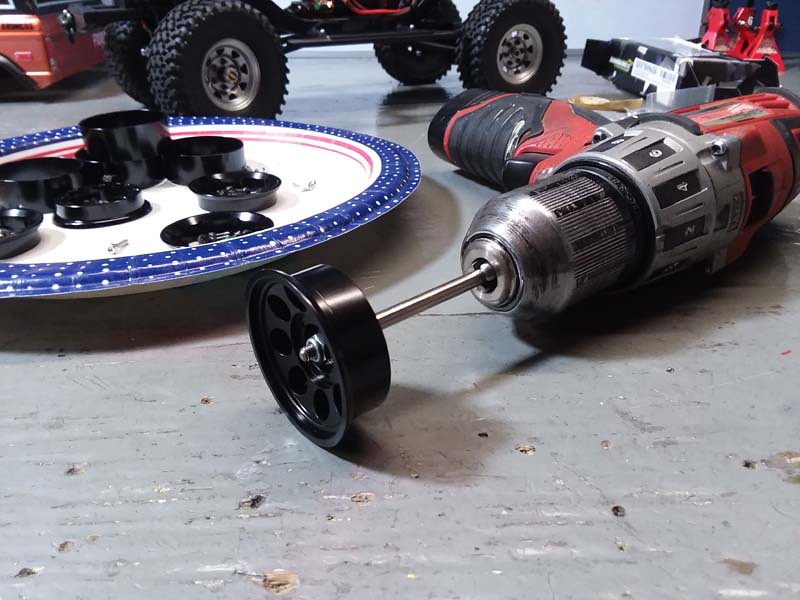

I think plain black wheels look a little bland, so I had the idea to add a machined lip to them. Chucked them into a drill using an old rear axle and broke out the sandpaper.

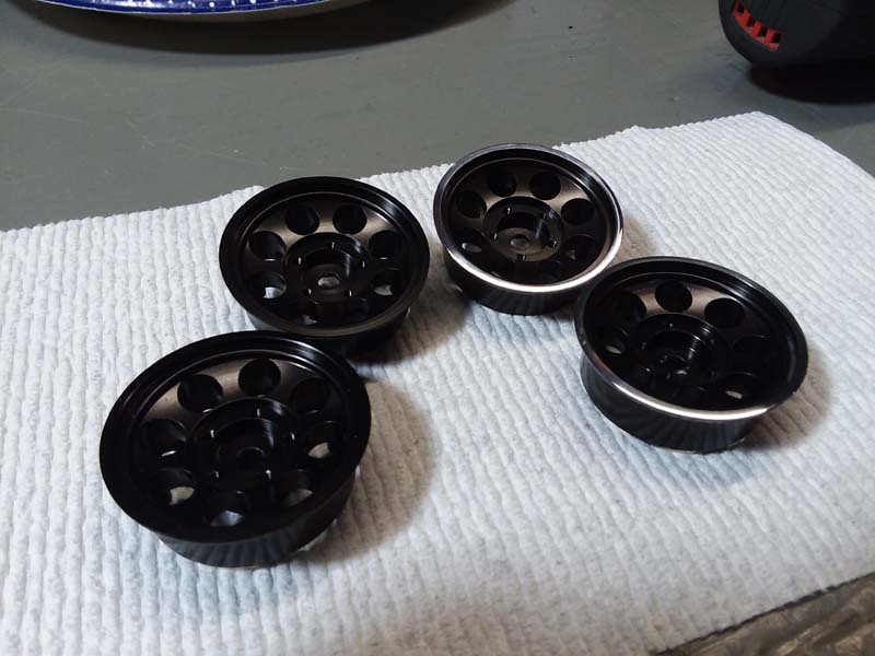

Used various grits of sandpaper and just sanded off the anodising on the lip. Machined on the right, stock on the left.
Had a bit of trouble mounting them to the Hustler tires, but they fell right on the Mud Thrashers. Had them together in under 10 minutes.
Adds a nice visual break between the wheel and tire..left the center caps off for now so I could add the hubs up front.

I ran them back to back this weekend - the Hustlers had way more grip then the Mudthrashers. About on par with Jato's MTR's he was running on his CMX. Agree the sidewalls look a git goofy. :)
