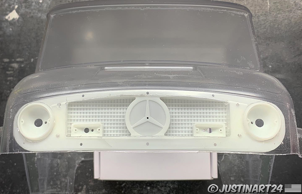

I am working on my loaner Axial Racing UMG10 truck and started some painting tonight. I was not looking forward to cutting out the headlight holes but used my leather punch to start the cut out. It ended up working out pretty good.
The grill mounted pretty easily, just with four phillips screws on the front. I also just super glued in the headlight covers and blinker covers.

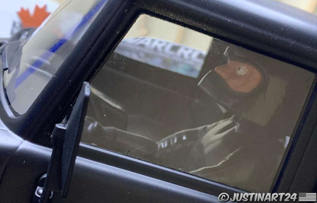

Here are some pictures of my Axial UMG10 from yesterdays 2020 WARCRC Scale Comp #3. The truck did really well, I have the RC4WD AX2 two speed transmission locked in first and the low end control of this truck with smaller tires is really nice and was fun to slowly crawl on the rocks. I do really like the wheelbase too, it really helped out with turning, even not running any OD or UD gears in the axles.
