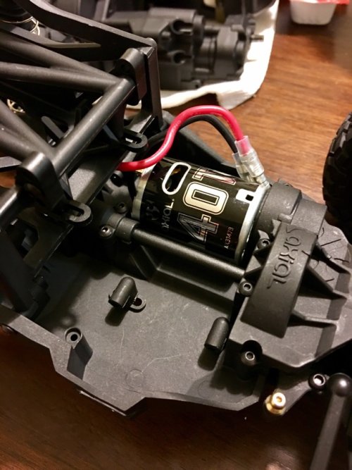

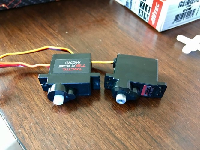

The 225 fits, barely. 54oz/in at 4.8v, 67 at 6v. Used losi mrc servo mounts. Filed slot on bottom of the chassis a hair. No room for the saver but on my losi minis usually a steering link will pop off the ball stud in a bad crash before anything breaks.
I wanted to use the same multi- model tx I use for everything so swapped out the esc/rx combo for a spektrum rx and an old losi brushed esc. Here's pics if anyone is wondering what it looks like with larger servo and separate esc and rx.
if the hitec 255mg fits (32.26 x 16.76 x 31.00), probably the Savox SW0250mg (29.5x14x32.5) will get in just fine.

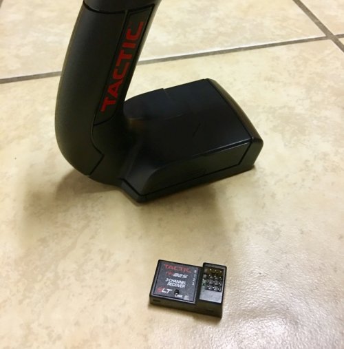

Page 8 of user manual lists accessories for the radio system, two of which being receivers with no ESC built in.
TACL0325 - TR325 3Ch 2.4GHz Receiver Only
TACL0326 - TR326 3Ch 2.4GHz RX Only HV
The second is the High Voltage (lipo) capable one. 6.0V max for the TR325, 8.4V max for the TR326. Should bind up with the stock transmitter. (But I have not tried this myself.)
I've had great luck with my FlySky GT3 system. It was like $35 and with some other mods, it programmable for multiple channels, models, etc.
The TR325 is what came in the Bomber RTR. Looks like I found the perfect use for it and I'll be able to add lights or something else later. Guess I'm getting a new ESC now too. At least that'll give me instant reverse as well as choosing whatever servo I want now. It's cool how Axial made provisions for modification the way they did.

Out with the new, in with the newer. :roll: I gotta say, I love how cheap the parts are for this thing compared to my 1.9 and 2.2 trucks. $20 for a "high torque" metal gear Hitec servo, $17 for a new lipo graphene battery. At this rate, it may cost me tens of dollars to upgrade the entire car. :ror:

Got the new servo installed, much better steering. Ran it around the kitchen for about 3 minutes then she stops dead. No steering, no throttle, nothing. Reset power 5 or 6 times in different order, ESC then remote, remote then ESC, nothing. Now I get to call Axial on Monday and tell them they sold me a complete lemon. What a disappointment. I'm replacing everything and taking this servo back for a better one. The stock electronics are garbage.
